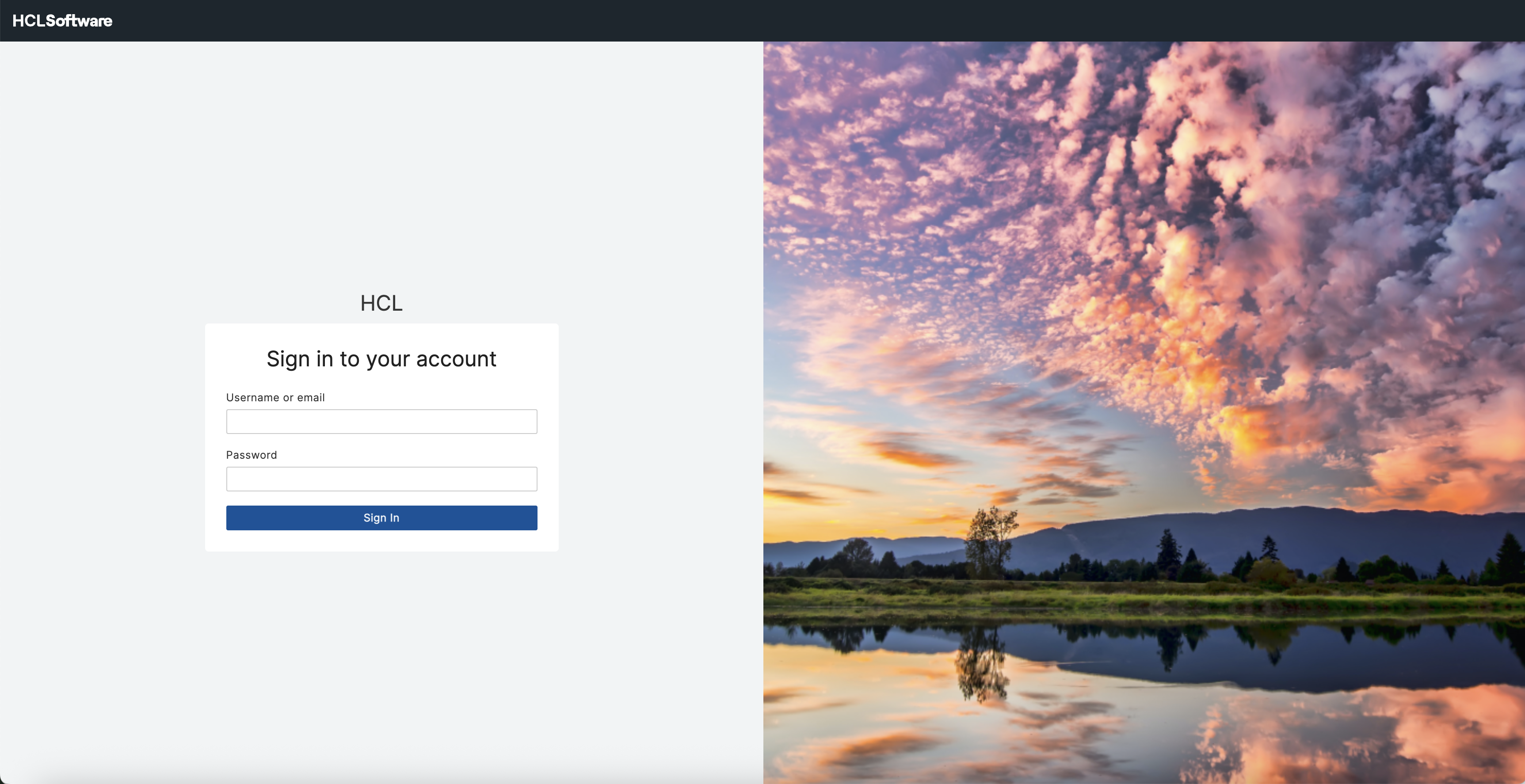

    6. Restart the Leap pod. After restarting the Leap pod, accessing Leap should redirect you to authenticate using your OIDC IdP.
      For example, the following screenshot shows an authentication page accessed using Keycloak:
