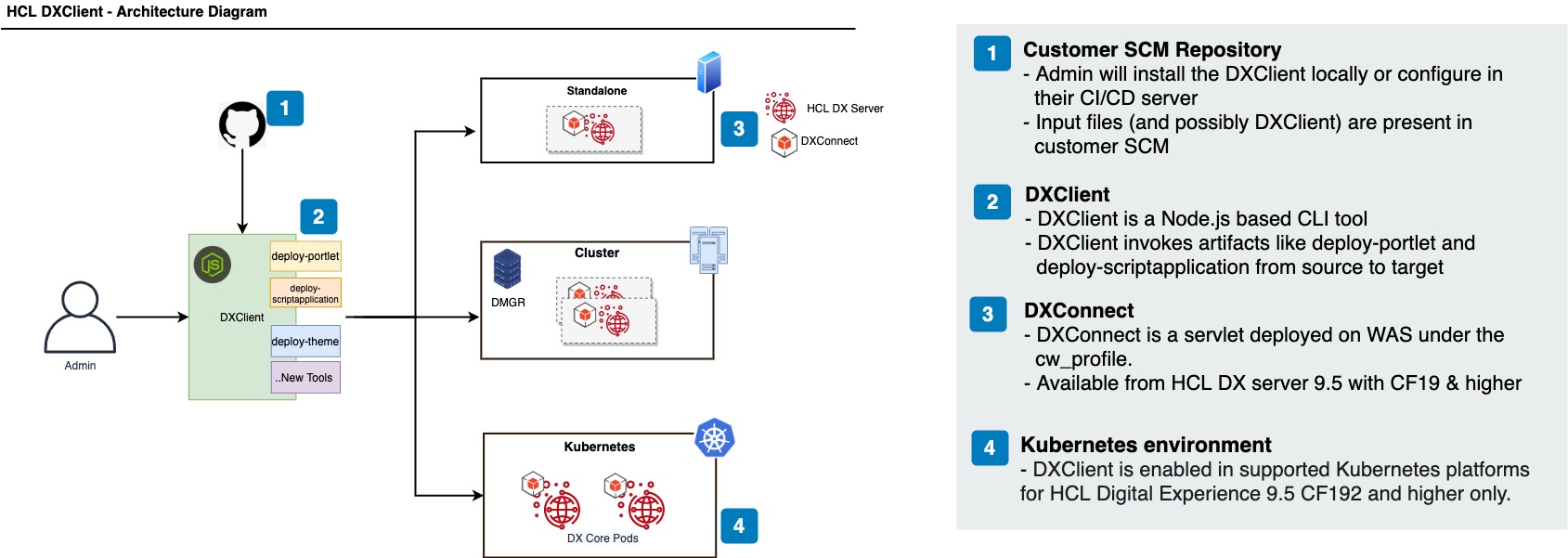

Architecture
HCL DXclient Architecture diagram
Note
  1. HCL DX 9.5 CF19 or later version is installed on target servers, on supported on premises platforms(Microsoft Windows, Linux).
  2. Beginning with HCL DX 9.5 Container Update CF192 and later releases, the DXConnect Servlet is pre-configured and started on supported Red Hat OpenShift and Kubernetes platforms that DX 9.5 containers are deployed to.
  3. For supported on premises platforms with HCL DX 9.5 CF19 and later releases, the DXConnect application needs to be installed (refer to DXConnect Installation) and started under the Configuration Wizard (cw_profile) on target servers. For more information on starting the Configuration Wizard, refer to Accessing the Configuration Wizard.
