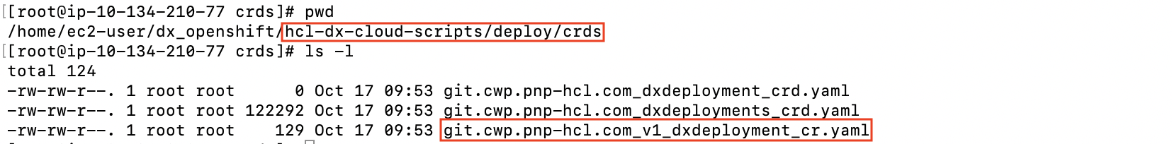

Customizing the deployment requires updating the deploy/crds/git.cwp.pnp-hcl.com_v1_dxdeployment_cr.yamlfile located in the hcl-dx-cloud-scripts/deploy/crds directory in the HCL Digital Experience 9.5 platform packages deployed.

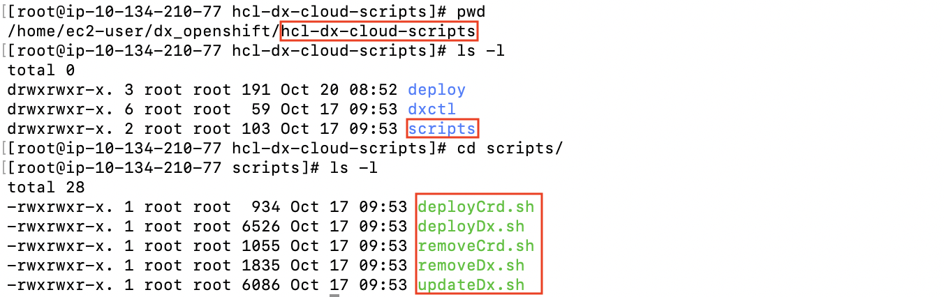

Deploy scripts
Reference the HCL Digital Experience Deployment topic for the list of supported platforms and latest HCL DX 9.5 container package list files that can be downloaded from your HCL Digital Experience entitlements on the HCL Software License Portal.
Once modified, the deployDx.sh or the updateDx.sh scripts should be run to perform (or update) the target deployment.
Update script location

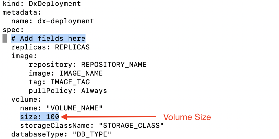

    • Volume Size
      By default, the volume size is 100 GB. This can be modified by changing the following:
      Volume size
      Note
      The volume name and storageClassName should not be modified here.

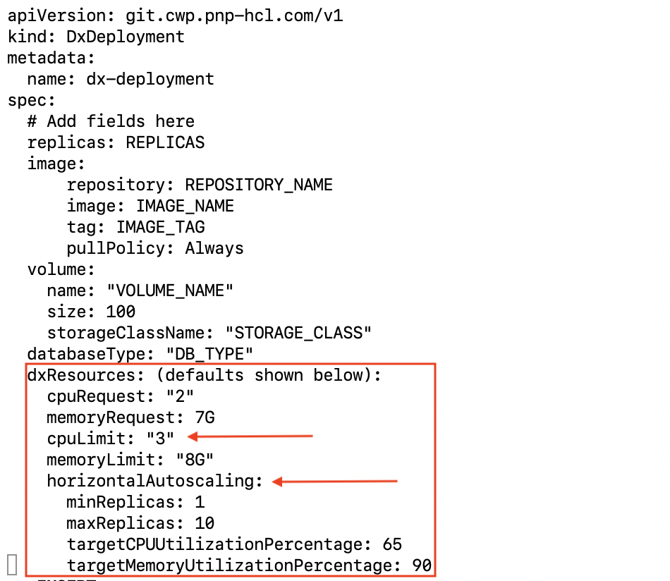

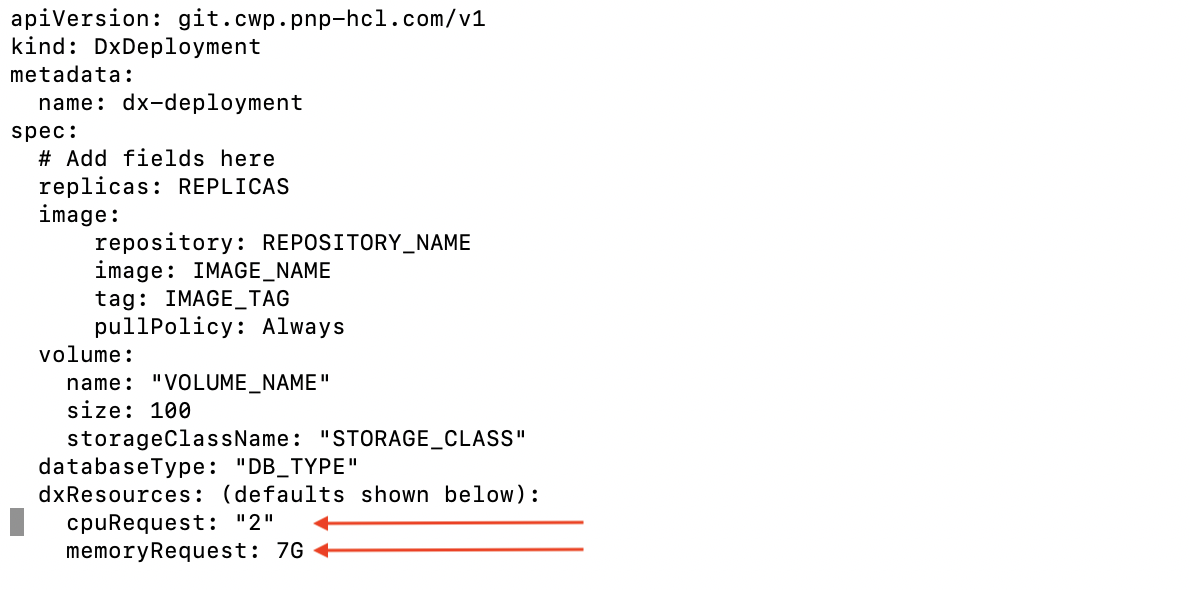

    • Resources
      By default, the resource requests are set at **2** CPU and **7G** RAM. These values can be changed. It is recommended to adjust the server heap size before changing these values.
      Resources
      Note
      Limits are not enforced in the initial 9.5 release.
    • HCL DX 9.5 Container Update CF171 and higher
      • Limits are enforced.
      • Auto-scaling based on average CPU and memory utilization can be configured.
        Auto-scaling
        When using a Horizontal Pod Autoscale Service, by design, scaling up the amount of HCL DX 9.5 pods is done one at a time. HCL DX 9.5 processes will initiate the requested single instance at a given time until the instance starting is started, to manage scaling in a controlled manager from 1 to N minimum pods set.
        Each deployment takes approximately ~3 to 4 minutes to start, operating on typical hardware environments. Pod instance terminations are also managed with these control practices.
        Scaling is controlled in the configuration map with these settings, which can be configured. In this example, 5 is the maximum number of DX 9.5 Container pods requested:
        dx.deploy.dxcore.resources.scale.maxreplicas: '5'
        dx.deploy.dxcore.resources.scale.minreplicas: '1'
        Custom resource allocation

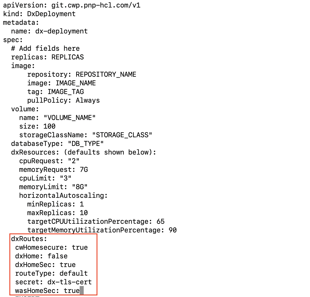

    • Routes/Ingress
      By default in 9.5, base routes are created for the deployment.
      HCL DX 9.5 Container Update CF171 and higher allows a customer to configure the available routes.
      You can enable or disable any route and change the name of the secret to be used in the TLS context. The Configuration Wizard is still impacted by the number of running instances.
      Custom DX routes

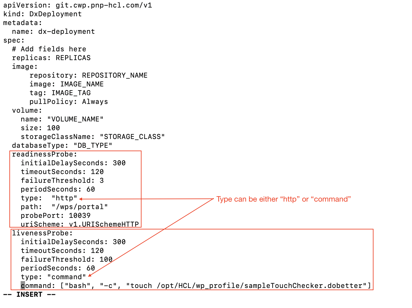

    • Probes
      The default readiness and liveness probes run against the ../ibm/console. This can and should be overridden.
      Probes
      Notes
      There are two types of checks:
      • **command** runs a command against the server
      • **http** hits either an http or an https URL. The syntax and required fields are shown in the above image.

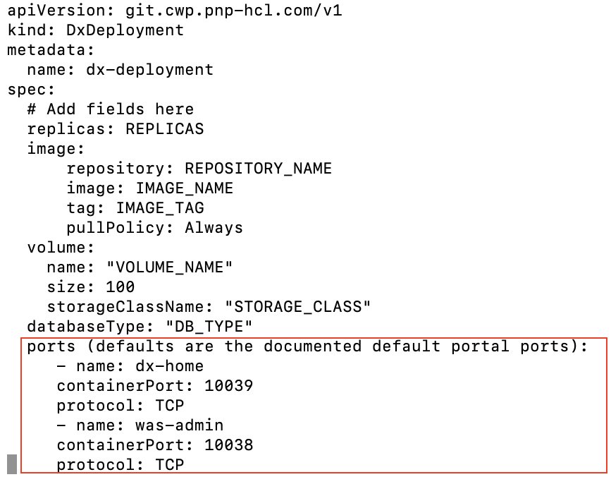

      • Ports
        By default, the deployment uses the default DX ports. The routes in these ports expose Portal through http and https.
        Custom ports
        Note
        If there is a need to configure the containerized Portal to use different ports, the defaults can be overwritten.
