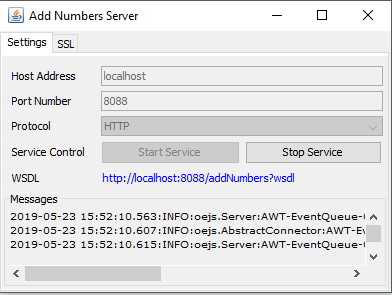

  1. In the local drive, go to <install_location>/DevOpsTestAPI/examples/addnumbers.
  2. Run the startup script.
    The Add Numbers Server window is displayed.
  3. Click Start Service.
    This action starts the Add Numbers web service on the host.
    Make a note of the Host Address and Port Number fields. You need them in the next steps.

  1. Return to the Add Numbers Server window. Select the WSDL URL displayed in the WSDL field (http://localhost:8088/addNumbers?wsdl) and press Ctrl+C to copy it.

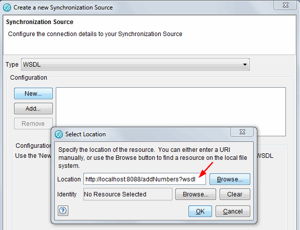

  2. Return to the Test Integrations and APIs window. In the toolbar, click Architecture School, and then click Logical View to view the canvas on which you will model the system.
  3. Paste the URL onto the canvas by clicking Edit > Paste. Alternatively, in the Synchronization Source window, click New. In the Select Location dialog, paste the URL into the Location field and click OK.
    Image of the Create a new Synchronization Source window.
  4. Click Next.
Test Integrations and APIs creates service components and operations on the canvas to represent the service described in the WSDL file. The options for creating tests and stubs from the service definition are also displayed. You have already used these options to create and run a test in Creating and running a test.

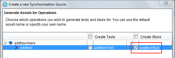

  1. In the Generate Assets for Operations page of the Create a new Synchronization Source window, select the additionStub check box in the Create Stubs column.
    This action creates a stub for the operation based on the interface defined in the WSDL file.

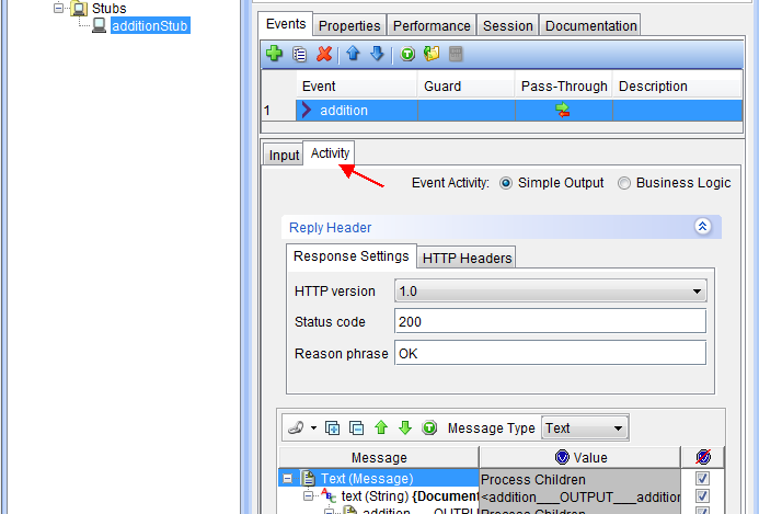

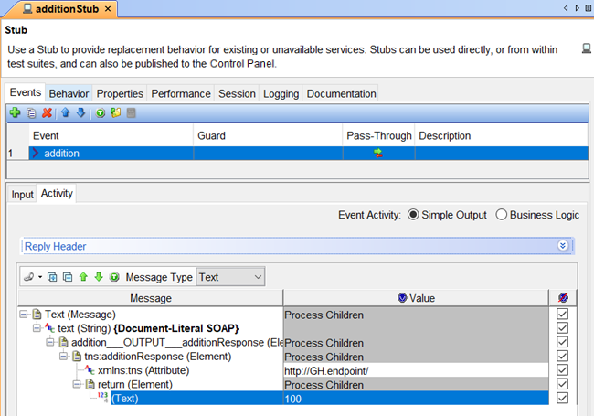

    The stub is opened in the Test Factory perspective, which is used for creating and editing tests and stubs.
    By default, the Events tab in the Stub editor is opened, which shows the events that the stub can handle. In this case, there is only one event for the addition operation. There are two sub-tabs under the Events tab labeled Input and Activity. When an event is selected, the Input tab displays the message that is expected to be received by the stub and that is handled by the selected event.
    Image showing the Events tab for the stub.
    The stub has the message structure for the SOAP message that the addNumbers addition operation expects as input. In the Activity tab, you can configure the response that is sent or other actions that are taken, when the stub receives a request that matches the data in the Input tab. Both the Activity tab and the Input tab contain the document structure, but no data yet.
    Image showing the Activity tab.
    On the Activity tab, the last two nodes in the tree called are called return (Element) (an XML element called return) and (Text) (the text content of that element).
  4. Adjacent to the (Text) node, double-click the blank cell in the Value column of the table. Enter the number 100 and press Enter. This is to check whether it is the stub that is returning the result in absence of the Add Numbers server.

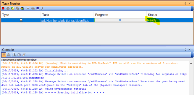

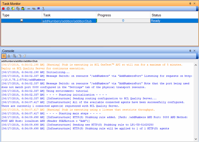

  1. In the toolbar, click Run or press F5.
    This action runs the stub in the Test Lab perspective.
    Image of the console log.

  1. Open the Test Lab view and verify that the stub is still running.
    The status of the stub shown in the Task Monitor must read Ready. If it reads Canceled, run the stub again.

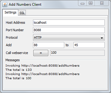

  2. Open the Add Numbers client by running the startup script located at C:\Program Files\HCL\DevOpsTestAPI/examples/addnumbersclient.
    image of the console log.
  3. Click the equal sign.
    The client returns 100 instead of the correct answer because this is the number that you configured in the stub when you created it in Creating a stub from the WSDL definition of the API.
    image of the Add numbers Client window.
    Instead of calling the Add Numbers server, the request got the response from the stub, which gives you complete control over the responses that the client receives to its requests, for example, while testing error cases.
