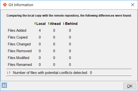

Click the area with the Git icon and numbers, to view the details of the files in the
repositories and files that are in conflict.
The Git Information window is displayed as shown in the following sample image.
The details of the files in the local repository that are modified with respect to the files in the remote repository are shown in the following table.
Status
Description
Local
The details of the files in the local repository.
Ahead
The details of the files in the local repository that are modified with respect to their version on the remote Git repository. The files in the local repository have changes that are not committed or pushed to the remote repository.
Behind
The details of the files in the remote Git repository that are modified with respect to their version on the local Git repository. The files in the remote repository have changes that are not yet pulled into the local repository.

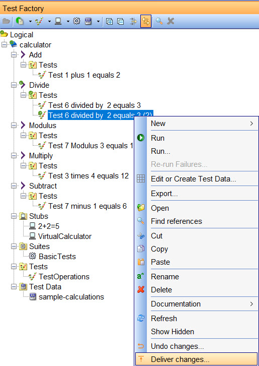

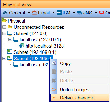

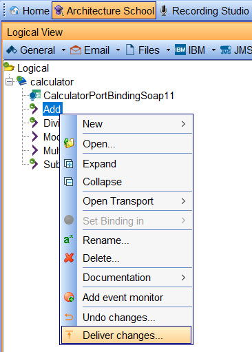

Delivering changes to the project in the Git repository
After you have made changes to the project files, you can deliver the changes in your local Git repository by using the UI option in Test Integrations and APIs to the project in the remote Git repository. This option performs the Git add, Git commit, and Git push operations on the files in that project to the remote Git repository.
- Set up the Git repositories.
- Ensured that the project files exist in the local repository.
- Opened the project from the local repository.
- Made changes in the project for the files to show as changed in the Test Integrations and APIs UI.
- If no new files are shown as present in the remote repository, you can continue with working on your project.
- If new files are shown as present in the remote repository, then you must perform the Update Project action to fetch the latest files from the remote repository.
After you complete making changes to your project files and you want to commit your files to the remote repository, you can use the Deliver changes option.
| If... | Then... | Result... |
You want to merge the changes in the files. |
You must perform the merge operation outside of Test Integrations and APIs by using your preferred Git method. |
Files in the local and remote repositories are merged. The changes that you made in your project files are retained in the merged files. |
You want to use the files in the remote repository and discard the changes you made in your project files. |
Perform the following actions:
The changes in your project files are discarded and files in the local repository are updated with the files from the remote repository. After you deliver the changes, files in the remote repository are updated and both repositories have the same files. |
To use the Menu option, complete the following steps:
To use the Git options in the Logical View (Tree View) of the
Architecture School perspective, complete the following steps:
To use the Git options in the Test Factory perspective, complete the
following steps:
To use the Git options in the Physical View of the
The changes that you made in your project files in Test Integrations and APIs are pushed to the project in the remote Git repository.

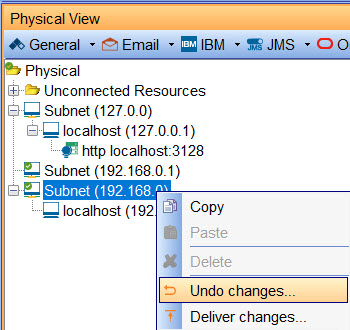

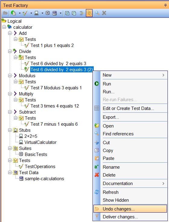

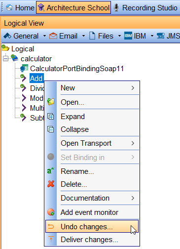

Undoing changes in the local repository
You can check out the project files from the remote Git repository to your local repository by using the UI options in Test Integrations and APIs. Use this option when you have uncommitted changes in the project files on your local Git repository and you want to ignore those and reload the project using files from the remote Git repository.
You can undo changes in your project files in the local repository by checking out the files from the remote Git repository. When you perform the Undo changes action in your project, the open editors in your project are refreshed and the files in the local repository are updated. All files that you had changed are discarded and are replaced with the files from the remote repository.
To use the Git options in the Logical View (tree view) of the
following steps:
The changes that you made in your local project files in Test Integrations and APIs are discarded and the latest version from the remote Git repository is checked out into the local repository.

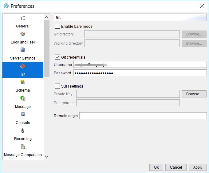

Setting preferences for Git
You can specify the Git directory and workspace when you are setting Git in the bare mode or specify your credentials to access the remote Git repository by using the Preferences option in Test Integrations and APIs. You can also configure the Secure Shell (SSH) settings or the name of the remote repository.
- From the Menu, click .
Click Git in the Preferences window.
Set up the Git repository in the bare mode by completing the following steps:
Set up your user credentials to enable access to the remote Git repository from Test Integrations and APIs by
- Select the Git credentials check box.
- Enter your user name that you set for the remote Git repository.
- Enter the password for the user name.
Set up the SSH communication between the client that hosts Test Integrations and APIs and the
server that hosts Git by completing the following steps:
- Select the SSH settings check box.
- Enter the location of the Private Key that must be used to authenticate the client with the remote server. Alternatively, click Browse, navigate to the directory, and then select the Private Key.
- Enter the passphrase configured for the Private Key in the Passphrase field.
Enter the name that you want to use for the remote repository in the Remote
origin field.
If you do not provide a name, the default name considered is origin.
- Click Apply, and then click OK to apply the preferences.
