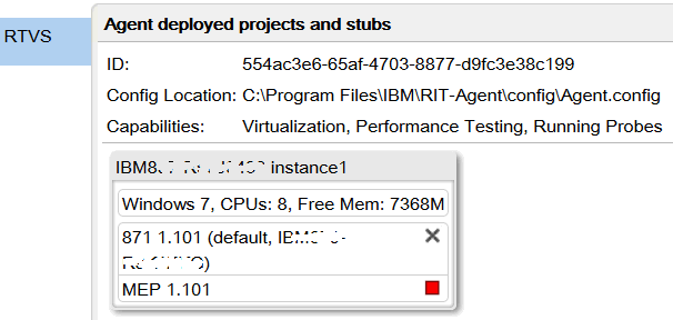

Identifying engines from logs
All engine processes started by an agent share a common log file name pattern as defined by the engine.java.util.logging.FileHandler.pattern property. Within the engine log file, INFO level messages are output with identity information:
INFO: instanceName: instance1
INFO: agentId: fb2348d5-6dec-40db-9046-44827513a44a
The instance name and agent ID can be matched to the name and ID that are shown in Test Virtualization Control Panel under the details for the Virtualization agent. To check to which stub and project this instance number applies, go to the Agents page and click search for the Virtualization agent:
agent_deployed
