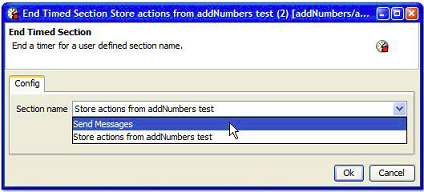

End timed section actions
The End Timed Section action marks the end of an individually timed section within the test.
To configure end timed section actions:
Except for selecting the appropriate action that marks the start of the required timed section in the test, there is nothing to configure within the test action.
If the test contains more than one timed section, it is important that each Begin Timed Section action is terminated with an appropriate End Timed Section action.

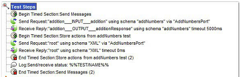

Using two timed sections, a simple timed test might look the test shown in the following graphic.
Certain test actions are not supported within timed sections. For information about this refer to Test action support for timed sections.
