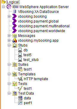

All test items are created in the Test Factory tree, on the left side of the perspective. Any test or test-related item that is created in the Test Factory can be edited in the editing panel, on the right side of the perspective.
The Test Factory tree
The Test Factory tree, to the left of the Test Factory perspective, contains all of your project resources such as components, operations, and test items. As tests and test items are added to the tree, they are automatically organized, by folder, under the operation in which they are created.
Test factory tree
