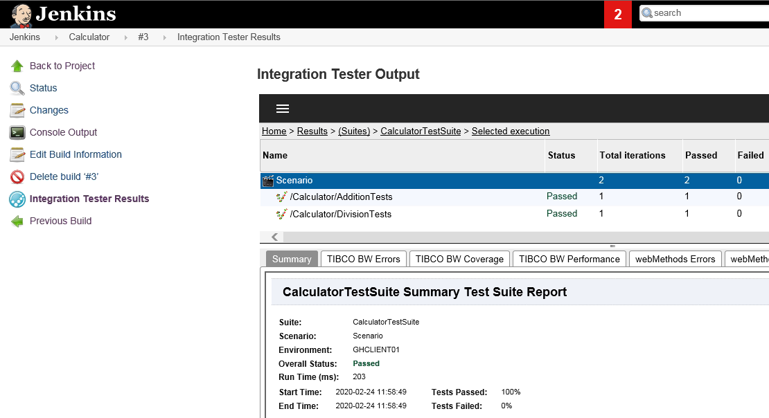

Click the Integration Tester Results link on the left
pane.
- Alternatively, click Test Results Analyzer option to view the history of test results in a tabular format.
An output page is shown with a HCL® Quality Server results page embedded. The relevant test suite results are displayed.
