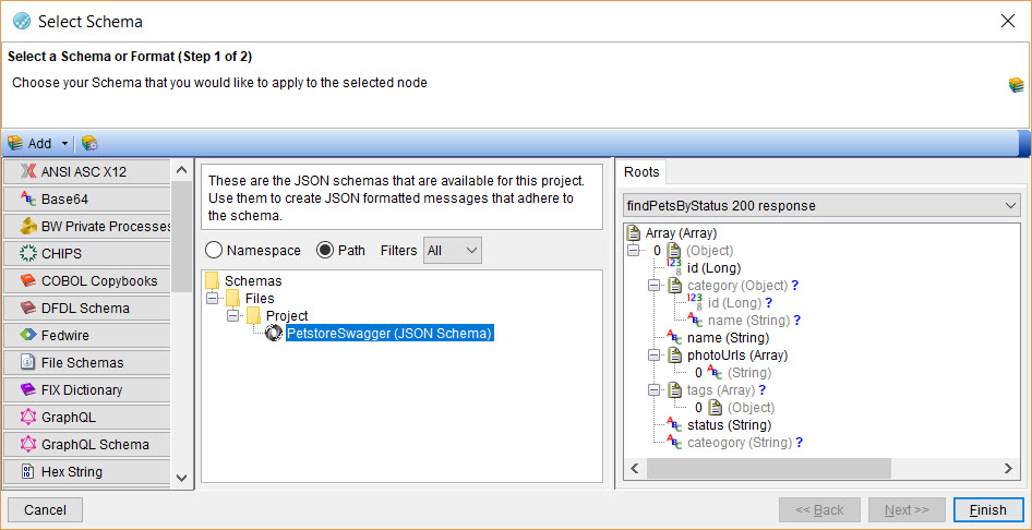

You must specify the schema and root for the schema, which is used to validate the schema in incoming messages with the schema in the expected message, and then validates the contract as adhered when both the schemas match.

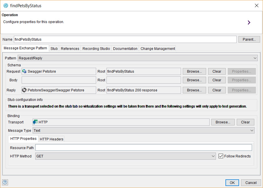

You can configure the MEP settings of the operation that you created for the logical resource from the Logical View.
- Double-click the operation to open the Operation dialog box.
- Click the Message Exchange Pattern tab, if it is not already open.
Select the messaging pattern that you want to use in your
tests from the list in the Pattern field.
You can select from the following options for the MEP that are listed for selection in the Pattern field:
- Request/Reply
- Publish/Subscribe
For example, you can select the Request/Reply MEP.

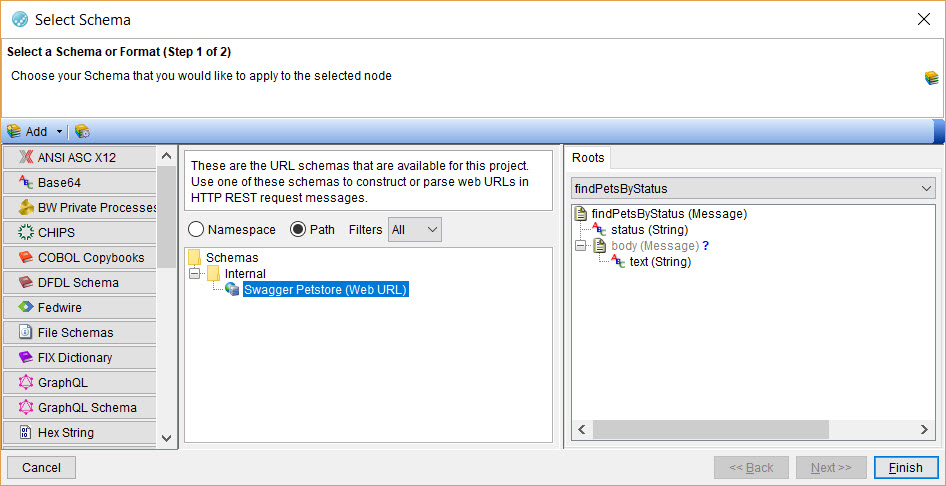

Complete the following steps in the Schema panel:

- Click OK to save the MEP settings and exit from the Operation settings dialog box.
