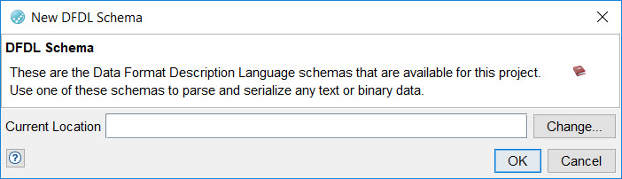

  1. In the Schema Library view of the Architecture School perspective, click the arrow next to the Add button, then click Other > DFDL Schema.
    The New DFDL Schema window is displayed.
    The New DFDL Schema dialog box.

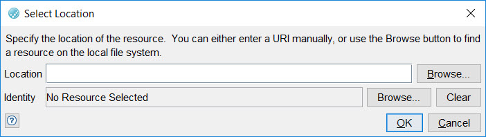

  2. In the New DFDL Schema window, click Change.
    The Select Location dialog box.
  3. In the Select Location dialog box, enter a full path to the file that contains the DFDL schema or click Browse, browse to the file, and click Open.
  4. Click OK when the correct path is displayed.
You have created a DFDL schema and added the schema to the schema library. The DFDL Schema Library lists the path to the created DFDL schema file.
