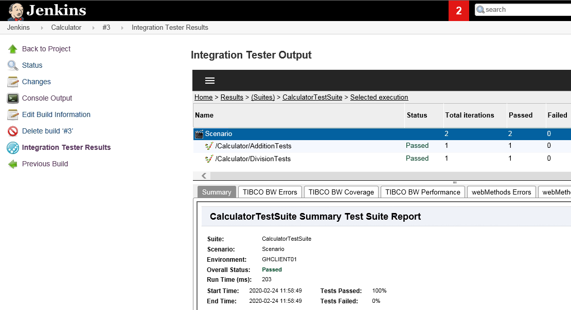

After configuring a Jenkins job to either run a test suite by using the Integration Tester Test Execution plugin or to run an Apache Ant build script generated by HCL OneTest™ API for a test suite, you can view test results within the Jenkins interface.
- Click Build Now by selecting the relevant job in Jenkins.
- Verify that the project has been rebuilt under the Build History option.
- Select the most recent build for the job under Build History.
Click the Integration Tester Results link on the left
pane.
An output page is shown with a HCL Quality Server results page embedded. The relevant test suite results are displayed.
