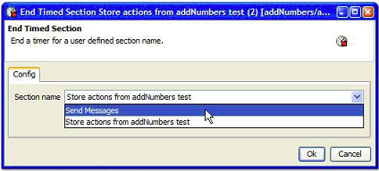

The End Timed Section action marks the end of an individually timed section within the test.
To configure end timed section actions:
Except for selecting the appropriate action that marks the start of the required timed section in the test, there is nothing to configure within the test action.

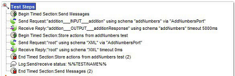

Using two timed sections, a simple timed test might look the test shown in the following graphic.
