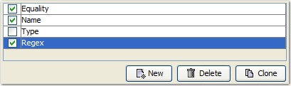

You can add more validations by clicking New. To delete a validation that you added, select it and click Delete.
To duplicate any validation (except for the Name and Type validations), select it and click Clone. The validations that are in the editor can be enabled and disabled by checking/unchecking the box next to them.

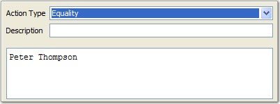

Equality
If Equality is chosen, the value to validate must be entered in the text field. The value can be pasted or loaded from a file, as described earlier.

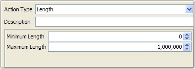

Length
If the required validation type is Length, specify the minimum and maximum lengths of the field value in the appropriate fields.

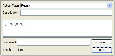

XPath and Regex
If XPath or Regex is selected as the action type, the XPath expression or the regular expression that is used to validate the field must be entered in the text field.
To help in building regular expressions and XPath expressions, a testing utility is available. By clicking Test, you can verify your expression against any arbitrary content without waiting for a full test that is run to show the results.
Values to validate against can be entered in the Document field. Alternatively, you can click Browse to locate and select a test document, the contents of which are loaded in the Document field.

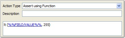

Assert by using function
To validate by using an HCL OneTest™ API function, select the Assert using Function action.
Use the menu to select any function that returns a Boolean type, which determines whether the assertion passes or fails. You can access the value of the field within the message by using the FIELD/VALUE tag, as shown.
