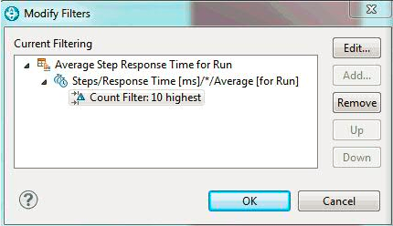

    1. Right-click anywhere on the Step performance report, and select Modify Filters in the context menu. In Modify Filters, select Count Filter: 10 highest (see figure 1) and click Edit.
    2. In the Performance Counter Filter wizard, select Filter by count. You can enter a new value in Number to Display, and select Show highest values or Show lowest values. For example, if you enter 15, the report will show the 15 highest response times or the 15 response times with the lowest values.
    Figure 1: Modify Filters
    Select Count Filter: 10 highest to modify the counter filter.

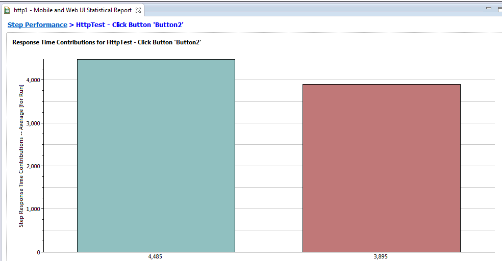

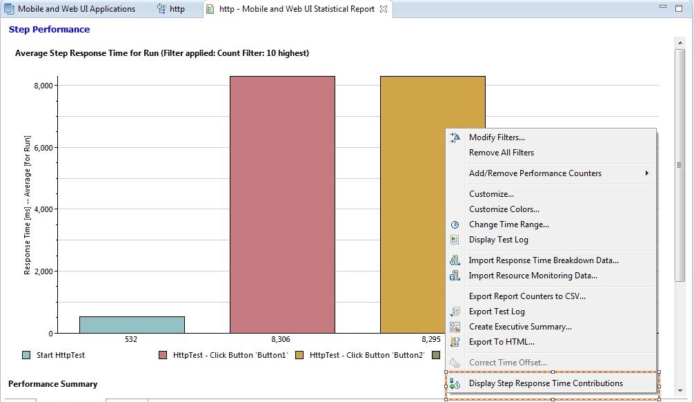

  3. Right-click any response time graph and, from the pop-up menu, select Display Step Response Time Contributions (see figure 2). A graph displays the time spent in the application On App Time, and another graph displays the time spent outside the application (in the network and server) Off App Time (see figure 3). If you do not select Collect Response Time Contribution Data when you run the test, no response time contribution data is collected for the steps in the test, and the Display Step Response Time Contributions option is unavailable.
    Response time is also measured for the first step, that is, the start step.
    Restriction: Off App Time is not measured for the start step of Web and Hybrid applications, for Android versions prior to 4.0.
    Figure 2: Response time contribution bar graphs for the 10 highest steps of the test
    The highest Step Response time for a test run
    Figure 3: On App and Off App Time for one selected step
    Response time contribution data for a step on app and off app
