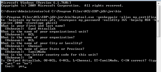

  3. The certificate generation process prompts you to enter some information about you. Enter the information as prompted.
    Command line tool
  4. If prompted for a password when using the keystore, enter the same password as provided on the command line.
    The key store file (.pfx) is stored in your current directory.
