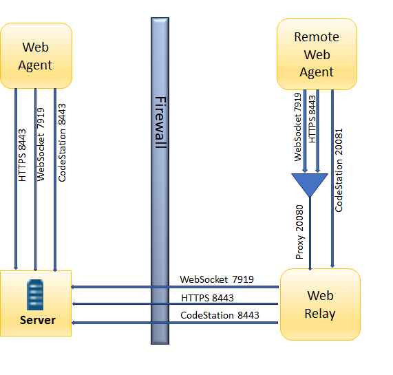

Communication between the servers, agents, and relays
The agent runs the deployment target host and connects with the Deploy server. Agents connect to server for low-latency, high-bandwidth, or real-time applications. Instead of each agent connecting directly to the server, agents connect to agent relays, which then connect to the server. The communication between the relays and the server is always unidirectional. The server does not initiate the connection with agents or agents relays.
The following diagram shows the main default ports that are involved in communication between the server, agents, and agent relays.
A diagram of the ports that agents, agent relays, and servers use to communicate; these are the same posts in the lists above
For more information on communication between the server, agents, and agent relays, see Agent security and communication, Agents, and Agent relays.

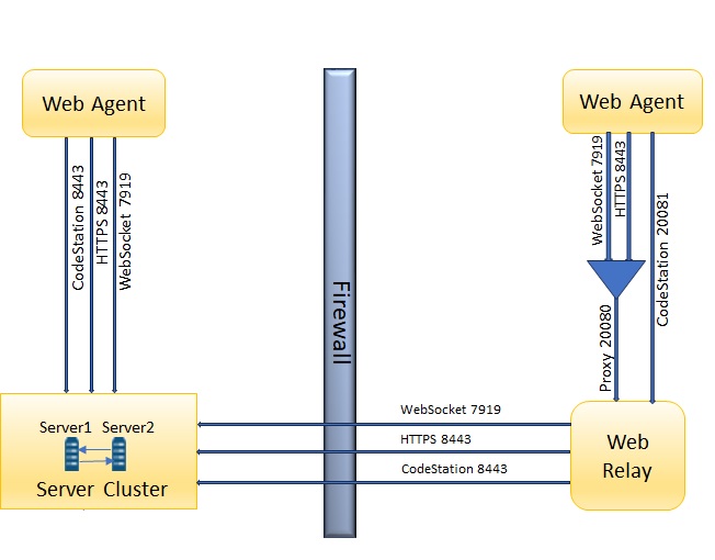

Communication between the server clusters, agents, and relays
The Deploy servers, within a server cluster, connect with each other. The Deploy agents connect with the server cluster. The remote agents connect with the server clusters by using the agent relays, communication between the relays and the server cluster is always unidirectional.
The following diagram shows the main default ports that are involved in communication between agents, agent relays and the server cluster.
A diagram of the ports that agents, agent relays, and server clusters use to communicate; these are the same posts in the lists above

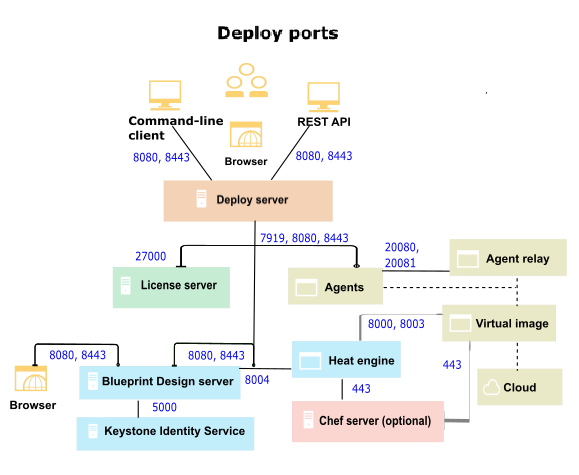

Communication ports topology
The following diagram shows the default port numbers that Deploy uses for communication. You can change most of these ports, depending on your choices during installation. The following diagram is only a summary of the default port numbers.
A topology that shows the ports that each part of Deploy uses for communication
As shown in the diagram, agents can connect to servers directly or through agent relays. You must ensure that the agent communication can get to the server through any firewalls or other limitations.
