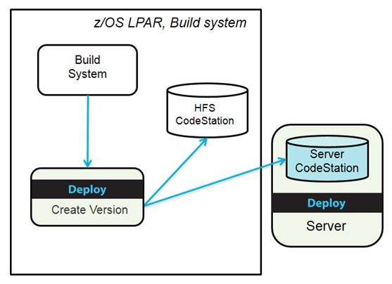

Choosing a CodeStation
You can select the default CodeStation type: Server Codestation.
The server CodeStation is part of the Deploy server. It is the CodeStation for all Windows, UNIX and Linux artifacts. It is the default CodeStation for z/OS artifacts.
Artifacts in Server CodeStation can be downloaded to any deployment targets using secured connections and using the same process step.
If you want to keep z/OS artifacts in the z/OS file system, use the HFS CodeStation.
The HFS CodeStation is provided to users who want to keep z/OS artifacts on the z/OS file system. A z/OS HFS directory is used to store the version artifacts. A copy or FTP step must used to transfer the artifacts to the target LPAR for deployment.
The default location of the codestation is agent install dir/var/repository. You can use symbolic links to link it to another directory.
