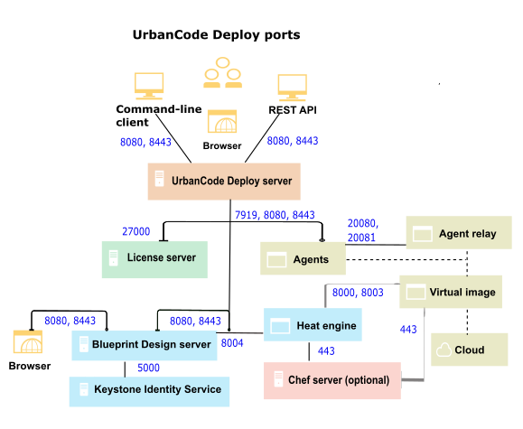

Communication ports topology
The following diagram shows the default port numbers that HCL Launch uses for communication. Most of these ports can change depending on your choices at installation time. The following diagram is only a summary of the defaults.
A topology that shows the ports that each part of HCL Launch uses for communication
As shown in the diagram, agents can connect to servers directly or through agent relays. You must ensure that the agent communication can get to the server through any firewalls or other limitations.
