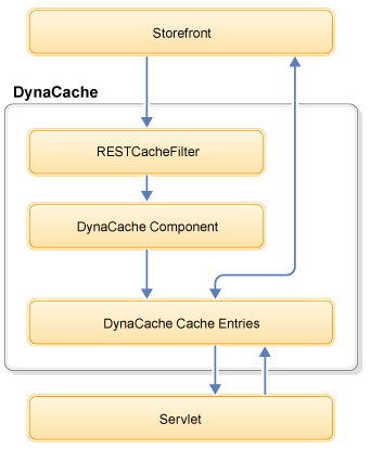

REST cache framework
The following diagram shows the REST cache framework interactions flow:
Where:
  1. RESTCacheFilter parses the request URI, tokenize it, and adds it to the attribute. It also gets the other attributes, such as previewToken, from the HTTP header.
    The path token is taken from the URL and set to the attribute with the servlet cache filter.
  2. The cache-id in the cachespec.xml file defines the rule for caching the REST request. The cache entry of a specific resource is generated with the cache-id.
  3. The dependency-id in in the cachespec.xml specifies the additional cache identifiers and associates them with existing dependency-id types.
  4. If the identifier-id needs to be converted, RESTMetaDataGenerator generates the dependency-id with an ID.
  5. If the cache-id exists in the DynaCache instance, it returns the cache entry directly from the cache. If the cache-id does not exist in the DynaCache instance, it calls the backend servlet to create the cache entry and returns the data to the requester.
