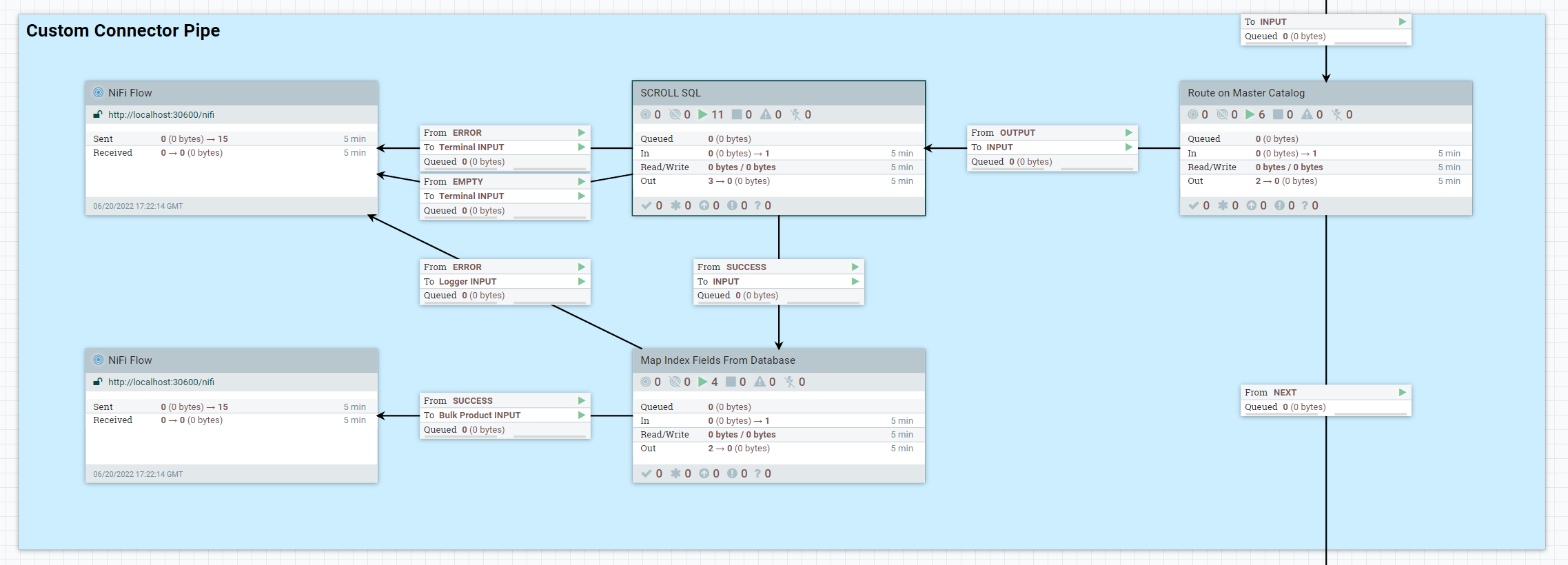

    3. Double-click on the Custom Connector Pipe Process Group. Once that opens, locate and double-click on the SCROLL SQL process group. Locate and right-click on the Define Custom SQL processor and stop the processor.

    1. In the Custom Connector Pipe process group, double-click on the Map Index Fields From Database process group.
    2. Locate the Transform Document - Map Index Fields From Database process group and stop the processor.

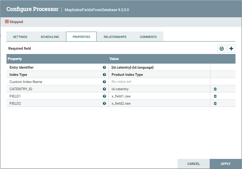

    3. Note the following mandatory properties.
      Entry Identifier
      "Entry Identifier" in this processor is the key used for the output document which will later be sent to Elasticsearch. Internally it is mapped with the field _id key used for the output document. This identifier can be expressed using flowfile and registry variables, as well as using index field names in the search response surrounded by square brackets [ ].
      For example, [id.catentry]-${param.langId} means [id.catentry] will be replaced with the value of an index field called id.catentry in the resulting index document, and ${param.langId} will be substituted in NiFi's expression language with a flowfile attribute or registry variable called param.langId.
      In case a user wants to use any other field as the placeholder for the Entry Identifier which are not part of the flowfile and registry variables, users must set these values against the Property Name to the database table field name and set the Property Value to the corresponding search index field path.
      If you are including the [id.catentry] and [id.language] placeholders in the Entry Identifier, their values will not be set unless you add an additional mapping to the properties. For example, adding the property CATENTRY_ID with the value id.catentry results in the [id.catentry] placeholder being correctly substituted.
      For 9.1.16.0 and above, by default, the field CATENTRY_ID is already present as the property name and mapped with id.catentry as the property value.
      By default the Entry Identifier value is set to [id.catentry]-[id.language]. Users can change this value to (if required), ${param.storeId}-${param.langId}-${param.catalogId}-[id.catentry]. For example, "11--1-11001-14206", where, param.storeId : 11, param.langId : -1 , param.catalogId : 11001, id.catentry : 14206.
      Index Type
      The type of search index in Elasticsearch, for example Product or Category. This value should not be changed for this tutorial.
    4. Define the mapping of custom database table fields to corresponding index fields. Set the Property Name to the database table field name and set the Property Value to the corresponding search index field path. The property value can be a multi-valued comma separated list to allow the same database table field to be mapped to more than one search index field name. For example:
      Value:  custom.x_field1.raw, custom.x_field1.normalized
      Note: Re-use the existing index schema mapping where possible, to simplify the customization logic.
    5. Click Apply.
    6. Start the processor by right-clicking on it and selecting Start.
