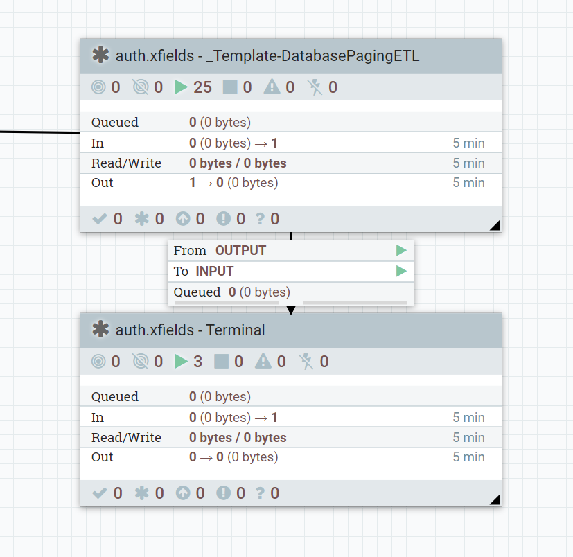

  5. Verify that your new connector has been created.
    Open the NiFi user interface. You should see your new process group on the far right side of the NiFi canvas. You can also search for “auth.xfields” using the Search tool in the upper right side of the NiFi status bar, to quickly locate your connector/pipeline.
You have created a new connector and are ready to configure the pipeline.
