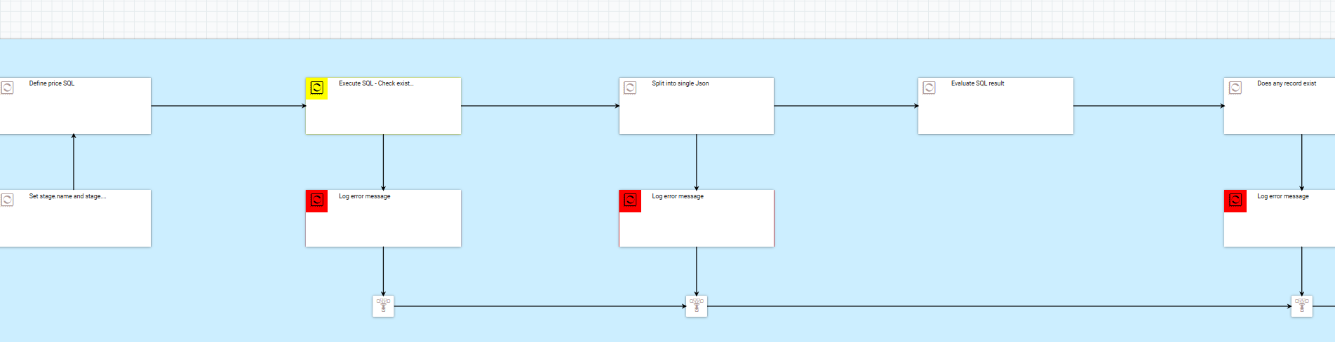

  3. Update processor Define custom SQL and index name.
    Note: Ensure that cost price data is available in your database. This connector does not verify if the SQL returns any results. If the cost price data is not available in the database, the data returned for the SQL is empty and results in errors. To verify that the cost price data is present in the database, check the indexing connector at auth.reindex > DatabasePriceStage1 > Find Prices > Execute SQL with Precheck.

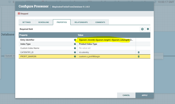

  4. Update the processor Transform Document - Map Index Fields From Database.
    1. Navigate to custom -_Template -DatabaseETL > Custom Connector Pipe > Map Index Field From Database.
    2. Right-click on the processor and stop it.
    3. Double-click the processor to modify its settings. The Configure Processors window opens.
    4. Under the Properties tab of the Configure Processors window, update the property Entry Identifier with the value ${param.storeId}-${param.langId }-${param.catalogId}-[id.catentry].
    5. Add a new property named PROFIT_MARGIN and give it the value custom.x_profitMargin.
      Your Configure Processors window will look similar to the following:
    6. Click Apply.

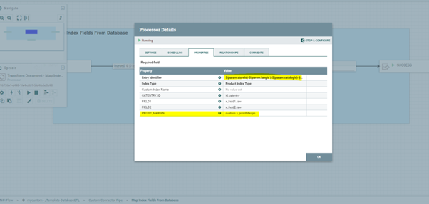

    7. Open the Processor Details window, remove the properties FIELD1 and FIELD2 from the Properties tab. Click OK.
