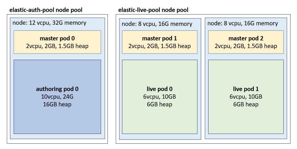

kubernetes dual nodegroup cluster

In Elasticsearch terminology, an Elasticsearch node refers to an instance of Elasticsearch. In Kubernetes, Elasticsearch nodes are deployed as stateful sets and run as pods. The sample deploys pods with the following configurations and limits:
group pods vcpu memory heap
master 3 2 2G 1.5G
auth 1 10 24G 16G
live 2 6 10G 6G

The sample is deployed in Google Cloud (GKE) using the following node configurations:
pools nodes vcpu memory
elastic-auth-pool 1 12 32G
elastic-live-pool 2 8 16G
