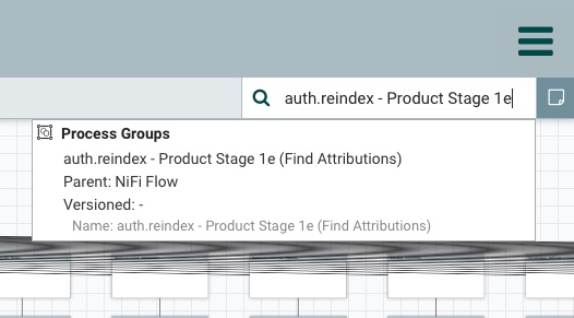

  5. Go to your NiFi console in a browser.
    http://nifi_hostname:port/nifi/
  6. Use the search bar to locate the stage referenced from your /status API call (from Step 3). For example, if the stage was auth.reindex - Product Stage 1e, look for the following element:
  7. Navigate through the process group until you find the processor(s) that contain recently processed data and note them for later investigation. For example, the following string indicates that the Execute SQL - Find Attributes processor has shown recent activity:
