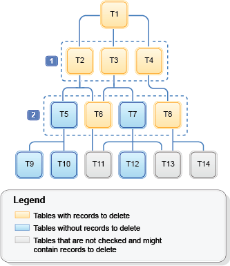

In contrast, when the utility runs in the offline mode, the utility does not use cascade-delete operations. Instead, the utility uses SQL delete statements for each table in the hierarchy to explicitly delete objects from each table. When the utility runs in the offline mode, the utility first checks the table hierarchy to identify the tables and hierarchy branches that contain records to delete. By default, the utility checks only the first two levels below the root table within a hierarchy. For example, in the following sample hierarchy, the utility checks the root table, T1, and any table within the first, 1, and second hierarchy level, 2.
Sample of records to be cleaned.

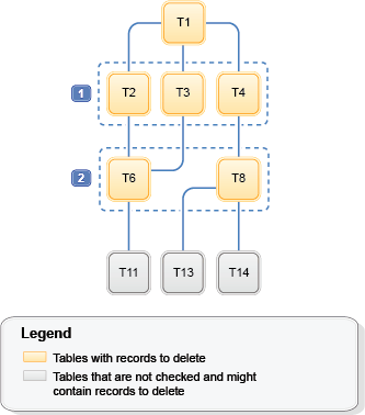

After the utility completes checking the hierarchy levels, the utility reduces the hierarchy by excluding any tables that do not include records to delete. Any child table of an excluded table is also excluded unless the table is also the child of a table that is included in the reduced hierarchy. For example, the tables, T11 and T13 in this sample hierarchy remain in the reduced hierarchy, even though the tables might not include records to delete. The following image shows how the utility can reduce the sample hierarchy by excluding the tables that do not have records to delete and the child tables of these tables.
Sample hierarchy of the database tables that remain after tables are excluded.

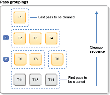

With the initial table hierarchy checked and reduced in scope, the utility groups the remaining tables into passes, which are based on the hierarchy level of the tables. Each pass can include multiple tables that belong within the same hierarchy level. There is no limit to the number of tables that can be included in a pass grouping. If a table includes foreign constraints to multiple tables, the table is included in multiple passes, one for each constraint.
For example, the following image represents the pass groupings for the remaining tables in the preceding sample hierarchy. In the sample hierarchy, the table T6 includes foreign constraints to multiple parent tables. The utility groups table T6 into two passes for the same hierarchy level. One pass for the constraint with T2, and the other pass for the constraint with T3.
Sample table groupings for deleting records
With the tables grouped into passes, the utility generates the delete SQL statements to run against each table within each pass. Only the records that match the SQL statement are deleted. The utility uses a bottom-up approach to run the SQL statements against the tables in each pass for a hierarchy. The utility begins cleaning each pass by running the SQL statements concurrently against all of the tables in the passes for the lowest level of the hierarchy. The utility then runs the SQL statements against the passes in each higher level in the hierarchy before the utility runs the SQL statement to clean the root table last.
