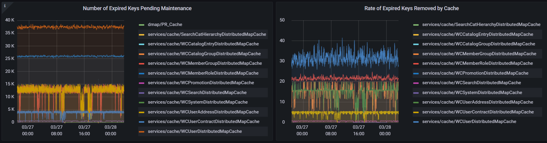

Expired maintenance (onlineExpiredEntriesMaintenance)
While Redis automatically removes expired cached values from memory, the expired maintenance process is responsible for removing expired cache entries from the metadata (dependency IDs). This process runs from all the pods and the speed is determined by the age of the oldest expired entry pending maintenance.
Expired maintenance cleanup rates
The speed of maintenance adjusts depending on the age of the oldest expired entry. For example, if the maintenance process finds cache entries that have been expired for seven minutes, it will use the maintenance configuration for objects from 5-8 minutes, which cleans at a rate of 20/second.

Expired maintenance details from the HCL Cache - Remote dashboard:
