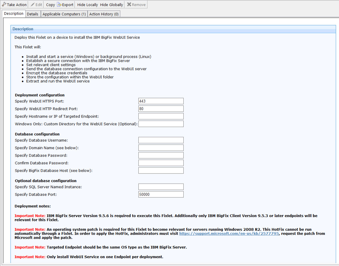

- The WebUI needs to connect directly to the BigFix Server database. If your
BigFix Server uses a remote database, the WebUI will connect to that database as
well. Routine database credential changes can cause the WebUI initialization to
fail, so the account used to access the WebUI database should be used
exclusively for that purpose.Note: If you change the account password after installing the WebUI, run the Deploy/Update WebUI Database Configuration Fixlet. The same Fixlet can also be used to repair a credential-based initialization failure.
- If you are using SQL Server:
- Select the appropriate value in the Specify Database Authentication Type field.
- If you selected Windows authentication, in the Specify Database Username field, enter your username in the format DOMAIN\username, where DOMAIN must be a NetBIOS domain name.
- If you selected SQL Server authentication, with an SQL credential, in the Specify Database Username field, enter your plain SQL Server username, the default is sa.
- In the Specify BigFix Server Database Host, enter the host name or the IP of the computer that hosts the database of your BigFix Server. The host name must be DNS-resolvable.
- You can use either the Specify SQL Server Named Instance field or the Specify Database Port field. Select one to edit it. To use the default database instance, enter its port, which by default is 1433. To use a named database instance, enter its name (e.g. SQLEXPRESS).
- If you selected to connect to a named database instance, enter the instance name in the Specify SQL Server Named Instance field.
- If you are using IBM DB2:
- In the target database computer, ensure that the DB2 configuration parameter extended_row_sz is set to ENABLED. Starting from DB2 10.5, this parameter is ENABLED by default. However, it could be set to DISABLED if DB2 has been upgraded from version 10.1 or earlier. This parameter can be manually changed. Ensure it is set to ENABLED for all Linux Server installations, otherwise the WebUI cannot start successfully.
- In the Fixlet, specify the DB2 database username and password.
- Enter the DB2 database port in the Specify Database Port field.
- Ensure that the following ports will be available and allowed:
- The default HTTP redirect port is 80.
- The default HTTPS port is 443.
- If you use SAML 2.0, the port 5000 of the WebUI server must be reachable by the Web Reports server and the BigFix main server. For more details, see How to configure BigFix to integrate with SAML 2.0.
- For its internal scope, WebUI uses also the port 5001. Ensure that it is available on the WebUI server.
Note: If the WebUI is installed on another machine, ensure that the WebUI port on the BigFix main server is allowed as well. The WebUI port value is calculated as follows: Server port number increased by 4. The Server port number can be configured by the BigFix Administrator during the installation and, as default, its value is 52311: the default value for the WebUI port is equal to 52315. For more information about the Server port number, see Step 2 - Requesting a license certificate and creating the masthead and Customizing the masthead parameters (root server installation on Windows and on Linux, respectively). - If you are installing the WebUI on a remote server and configuring WebUI to work with SAML, set
the
_WebUI_AppServer_Hostnamekey of the BigFix server computer to the host name of the computer where the WebUI is installed. - Deploy the Fixlet.
