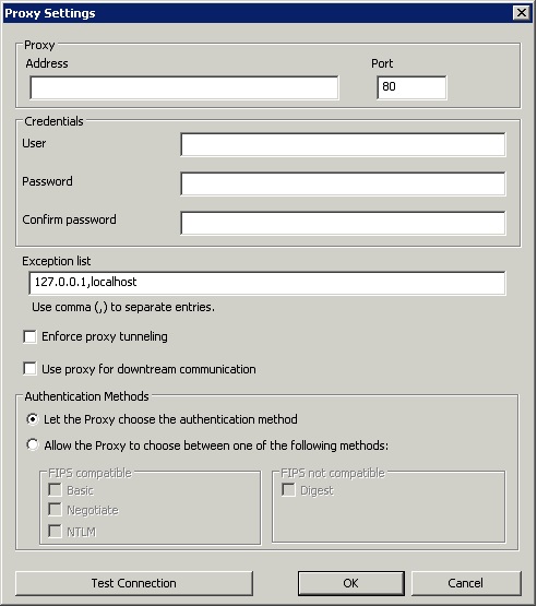

BESAdmin.exe /setproxy opens
the Proxy settings panel filled in the current proxy settings.
The same panel is displayed
whenever you run the BESAdmin.exe command to set
one or more specific proxy settings. Check that the values displayed
are correct, modify them if necessary and then click OK to
