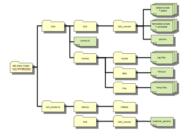

After you run the Deploy and Run Security Checklist task, the scripts are in a directory under /var/opt/BESClient/SCM.
The following image is a graphical representation of the directory structure.
| Directory/Script | Description |
| <BES Client Folder> / SCM | This directory is the base directory for the OS-specific check scripts and the master script (runme.sh). The contents of this directory are overwritten each time the ‘Deploy and Run Security Checklist’ task is run from the Endpoint Manager console. |
| ../SCM/util | A subdirectory of the BES Client Folder / SCM directory, this subdirectory contains utility scripts that are used by the master script and in the individual detection and remediation scripts. The primary utility that is found in this directory is the ‘globalfind’ script. |
| ../SCM/$OS/$OS_version | This directory is specific to the platform on which it runs, as specified by $OS and $OS version. For example, the Red Hat Enterprise Linux 4 shows as (../SCM/Linux/4). This directory path contains the specific detection scripts, remediation scripts, and the base parameter file that is used by the scripts. Each check script is named with the corresponding control ID that is used to describe the check. Each corresponding Fixlet also references the check ID. |
| ../SCM/runme.sh | This script is the master script that is called by the Deploy and Run Security Checklist task within the Endpoint Manager console. This script runs the ‘globalfind’ script and the individual check scripts. |
| ../SCM/mytmp/results | This folder is where the OS-specific detection scripts write their log files. These logs are examined by Fixlets and used to determine if a check is compliant or non-compliant. Each log file corresponds to the check ID for the given check. |
| ../SCM/mytmp/data | This folder contains the find.out file. This file is generated by the globalfind script and contains a directory listing of all local file systems and other information. This file is used by many of the OS-specific scripts and is updated only when the globalfind script is run. |
| <BES Client Folder>/scm_preserve | This directory is the base directory that is used to retain the rollback scripts, custom checks, parameters, and other information that is not intended to be overwritten each time the ‘Deploy and Run Security Checklist’ task is run. |
| ../scm_preserve/backup/rollback | Each time a remediation script is run, a corresponding rollback script is created. This script allows the administrator to roll back to the previous setting associated with the specific check. |
| ../scm_preserve/$OS/$OS_version | This directory might contain custom scripts that are produced by the administrator and not provided by Endpoint Manager. Scripts that are in this directory must conform to the input or output specifications are run with out-of- the-box checks when running the ‘Deploy and Run Security Checklist’ task. |
| ../scm_preserve/$OS/$OS_version /customer_params |
This file is used to store any custom parameters that are defined by the administrator. Any parameters defined in this file override the default parameters specified in the params file stored in <BES Client Folder>/SCM/$OS/$OS_version/params). |
