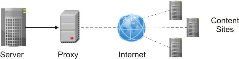

If your enterprise uses a proxy to access the Internet, your BigFix environment can use that communication path to gather content from sites.
In this case, you must configure the connection to the proxy on the BigFix server.
During a fresh installation, you are asked if you want to configure the communication through a proxy. The configuration settings that you enter are saved and used at run time to gather content from sites. For information about configuring a proxy connection at installation time, see Installing the Windows primary server for Windows systems, or Installing the Server for Linux systems.

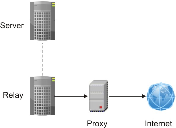

- A relay connected to the Internet through a proxy to download files
To set this configuration on the relay:- Run the steps that are described in Setting up a proxy connection on a relay to configure on the relay the communication to the proxy.
- From the BigFix console set on the
relay the following additional values to ensure that data is downloaded exclusively from the
internet rather than from the parent
relay:
For more information about these configuration settings, see Gathering content._BESGather_Download_CheckParentFlag = 0 _BESGather_Download_CheckInternetFlag = 1
Note: To prevent communication from the relay to the server from going through the proxy, ensure that the proxy exception list is set on the relay as follows: "127.0.0.1, localhost, <serverIP_addess>, yourdomain.com".- A client connected through a proxy to communicate with its parent relay

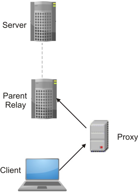

To set this configuration, on the client run the steps that are described in Setting up a proxy connection on a client and in Enabling client polling.- A relay connected through a proxy to communicate with a parent relay

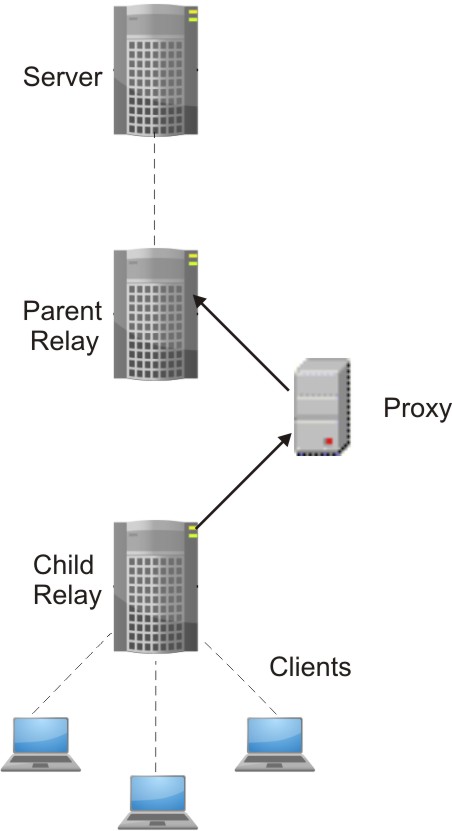

Complete these steps to implement this configuration:- On the child relay run the steps that are described in Setting up a proxy connection on a relay and in Enabling client polling.
- Disable the relay notifier on the parent relay.
