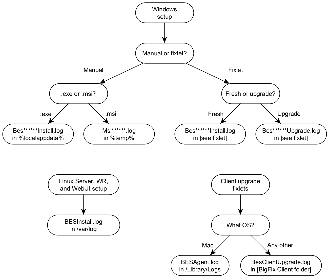

Manual installation and upgrade logs on Windows
Before BigFix 10.0.8, no log is created by default when manually running a BigFix installer on Windows.
Such logs can still be created by passing specific options to the installers or by changing the default Windows settings as described here to globally enable the installation logging.
Starting from BigFix 10.0.8, if you run an .exe setup manually to install or upgrade a
BigFix component, the installation log will be saved in the %LocalAppData%
folder.
BesClientInstall.log, for the ClientBesConsoleInstall.log, for the ConsoleBesInstallationGeneratorInstall.log, for the Installation GeneratorBesPluginPortalInstall.log, for the Plugin PortalBesRelayInstall.log, for the RelayBesServerApiInstall.log, for the Server APIBesServerInstall.log, for the Server and/or Web ReportsBesWebUiInstall.log, for the WebUI Service
If you run an .msi setup manually to install or upgrade a BigFix component, the
installation log will be saved in the %temp% folder. Their names are
randomly generated but follow the pattern: Msi*.log.
Manual installation and upgrade logs on Linux
On Linux, the BigFix Server installer always produces a log by default and saves it in
/var/log/BESInstall.log.
Remember that the BigFix Server installer can install several components at once: the Server, Web Reports, the WebUI and the Client.
The Client upgrade Fixlets create a log since BigFix Version 10 Patch 8.
