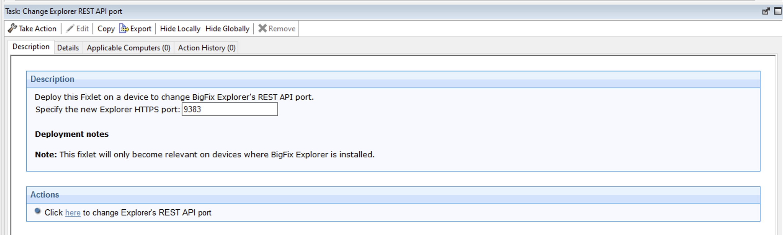

As an alternative, to modify the port for the BigFix Explorer, you can also run the Change Explorer REST API port Fixlet.
In the Description pane of the Fixlet, you can define the new port value to be used by the BigFix Explorer. The accepted values range from 1 to 65534.
The actionscript present in the Fixlet checks at runtime, through the BigFix Agent, that the defined port is not already in use on the machine. If this is the case, the Fixlet fails.
- Changes the
_BESExplorer_HTTPServer_PortNumbersetting. - Alters the firewall rule (both on Linux and Windows) replacing the port number with the new one.
- Restarts the BigFix Explorer service.

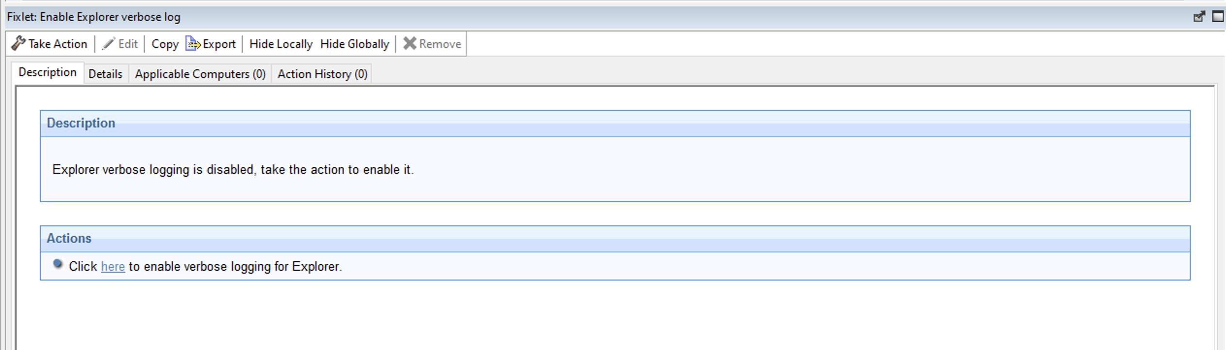

Use the Enable Explorer verbose log Fixlet to enable the verbose logging on the BigFix Explorer.
The Enable Explorer verbose log Fixlet sets
the _BESExplorer_Logging_EnabledLogs setting to enable all logs.

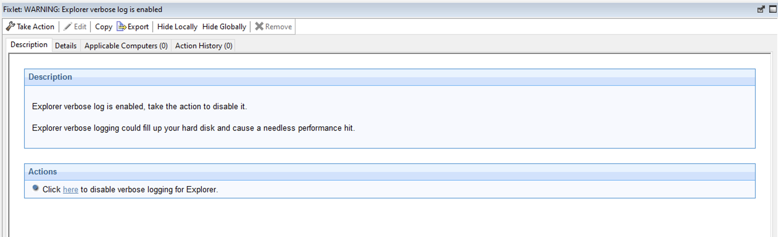

Use the WARNING: Explorer verbose log is enabled Fixlet to disable the verbose logging on the BigFix Explorer.
The WARNING: Explorer verbose log is enabled
Fixlet sets the _BESExplorer_Logging_EnabledLogs setting to "critical".
