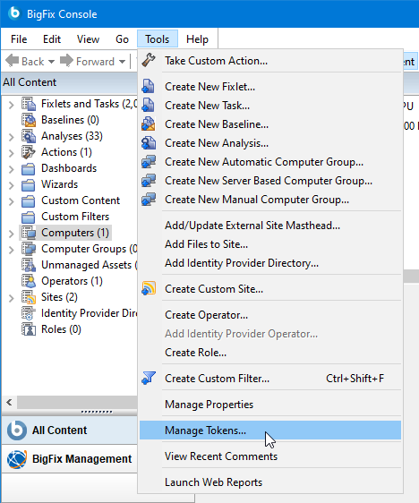

Using the BigFix Console, from the Tools menu, navigate to the Manage
Tokens... menu item.
