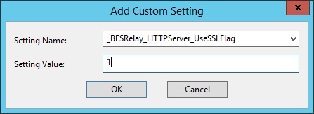

- Look for _BESRelay_HTTPServer_UseSSLFlag setting. If it exists,
do not create a second one, but edit its value to
1to enable HTTPS. If it does not exist, add it:

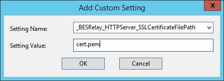

- Look for _BESRelay_HTTPServer_SSLCertificateFilePath setting.
If it exists, do not create a second one, but edit its value to the full path name of
the .pem file which might contain both the certificate and private key for the server,
or only the certificate. If this setting does not exist, add it:
Ensure that the.pemfile is in standard OpenSSL PKCS7 .pem file format.The certificate is supplied by the server to connecting clients and they present a dialog to the user containing information from the certificate. If the certificate meets all of the trust requirements of the connecting client, then the client connects without any interventions by the user. If the certificate does not meet the trust requirements of the client, then the user will be prompted with a dialog asking them if it is OK to proceed with the connection, and giving them access to information about the certificate. A trusted certificate is signed by a trusted authority (such as Verisign), contains the correct host name, and is not expired.
