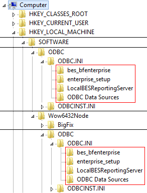

ODBC data sources are saved in the registry:
- 32-bit ODBC data sources appear in HKEY_LOCAL_MACHINE\SOFTWARE\Wow6432Node\ODBC\ODBC.INI
- 64-bit ODBC data sources appear in HKEY_LOCAL_MACHINE\SOFTWARE\ODBC\ODBC.INI
You can edit them directly or configure them using these dedicated tools:
- Start > Windows Administrative Tools > ODBC Data Sources (32-bit)
- Start > Windows Administrative Tools > ODBC Data Sources (64-bit)

[HKEY_LOCAL_MACHINE\SOFTWARE\Wow6432Node\ODBC\ODBC.INI]
[HKEY_LOCAL_MACHINE\SOFTWARE\Wow6432Node\ODBC\ODBC.INI\bes_bfenterprise]
"Database"="BFEnterprise"
"Driver"="C:\\Windows\\SysWOW64\\msodbcsql18.dll"
"Registration"="System Data Source"
"Server"="(local)"
"Trusted_Connection"="Yes"
"Encrypt"="Yes"
"TrustServerCertificate"="Yes"
[HKEY_LOCAL_MACHINE\SOFTWARE\Wow6432Node\ODBC\ODBC.INI\enterprise_setup]
"Server"="(local)"
"Encrypt"="Yes"
[HKEY_LOCAL_MACHINE\SOFTWARE\Wow6432Node\ODBC\ODBC.INI\LocalBESReportingServer]
"Database"="BESReporting"
"Server"="(local)"
"Encrypt"="Yes"
[HKEY_LOCAL_MACHINE\SOFTWARE\Wow6432Node\ODBC\ODBC.INI\ODBC Data Sources]
"enterprise_setup"="ODBC Driver 18 for SQL Server"
"bes_bfenterprise"="ODBC Driver 18 for SQL Server"
"LocalBESReportingServer"="ODBC Driver 18 for SQL Server"
[HKEY_LOCAL_MACHINE\SOFTWARE\ODBC\ODBC.INI]
[HKEY_LOCAL_MACHINE\SOFTWARE\ODBC\ODBC.INI\bes_bfenterprise]
"Driver"="C:\\Windows\\system32\\msodbcsql18.dll"
"Server"="(local)"
"Encrypt"="Yes"
[HKEY_LOCAL_MACHINE\SOFTWARE\ODBC\ODBC.INI\enterprise_setup]
"Server"="(local)"
"Encrypt"="Yes"
[HKEY_LOCAL_MACHINE\SOFTWARE\ODBC\ODBC.INI\LocalBESReportingServer]
"Server"="(local)"
"Encrypt"="Yes"
[HKEY_LOCAL_MACHINE\SOFTWARE\ODBC\ODBC.INI\ODBC Data Sources]
The "Trusted_Connection" registry value is set to "Yes", which means it is using Windows authentication. If that value is missing, the connection defaults to SQL Server authentication.
