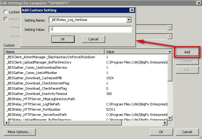

Enabling logging through the BigFix Console
- Log in to the console as a master console operator.
- Right click the BigFix Server or relay computer in the console.
- Select Edit Computer Settings....
- Check in the list to see if the _BESRelay_Log_Verbose setting has already been created. If it has, click the button Edit and change its value to 1 (to enable it).
- If the setting has not been created, click the button Add to create it. Enter
_BESRelay_Log_Verbose for the setting name and 1 for the setting value to enable
the verbose logging.
- Click OK. An action named "Change '_BESRelay_Log_Verbose' Setting" is taken targeted at the BigFix server or relay machine.
- After the action has completed successfully (and the setting has been applied), the new logging level is effective for the BES Root Server service, while the restart of the BES Relay service is needed for BigFix relay. You can take action on Task # 447: Restart Service in the BES Support site to do this.

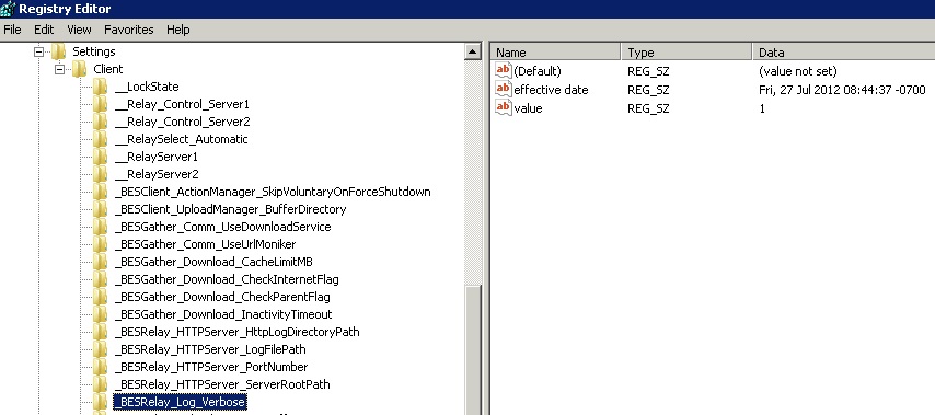

Enabling logging manually through the registry (Windows)
- Log in to the BigFix server or relay machine.
- Open up the registry editor (regedit).
- Add the registry key _BESRelay_Log_Verbose in HKEY_LOCAL_MACHINE\SOFTWARE\Wow6432Node\BigFix\EnterpriseClient\Settings\Client.
- Create a REG_SZ value named "value".
- Set the value to 1.
- Restart the BES Relay service if on a relay, while it is not needed on the BigFix Server.
Verbose data is output to <BigFix_Server_Installation_Folder>\BESRelay.log file on the server and <BigFix_Relay_Installation_Folder>\logfile.txt on a relay.
