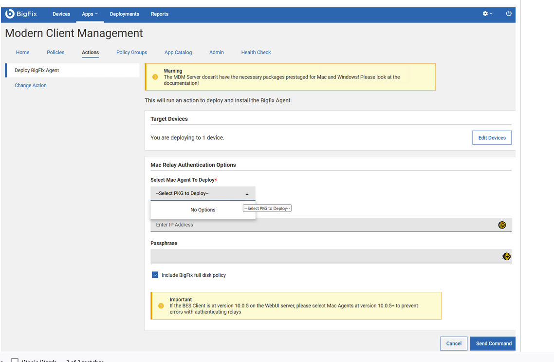

Unable to deploy BigFix Agent, even though the BigFix Installer is pre-staged in MDM server.

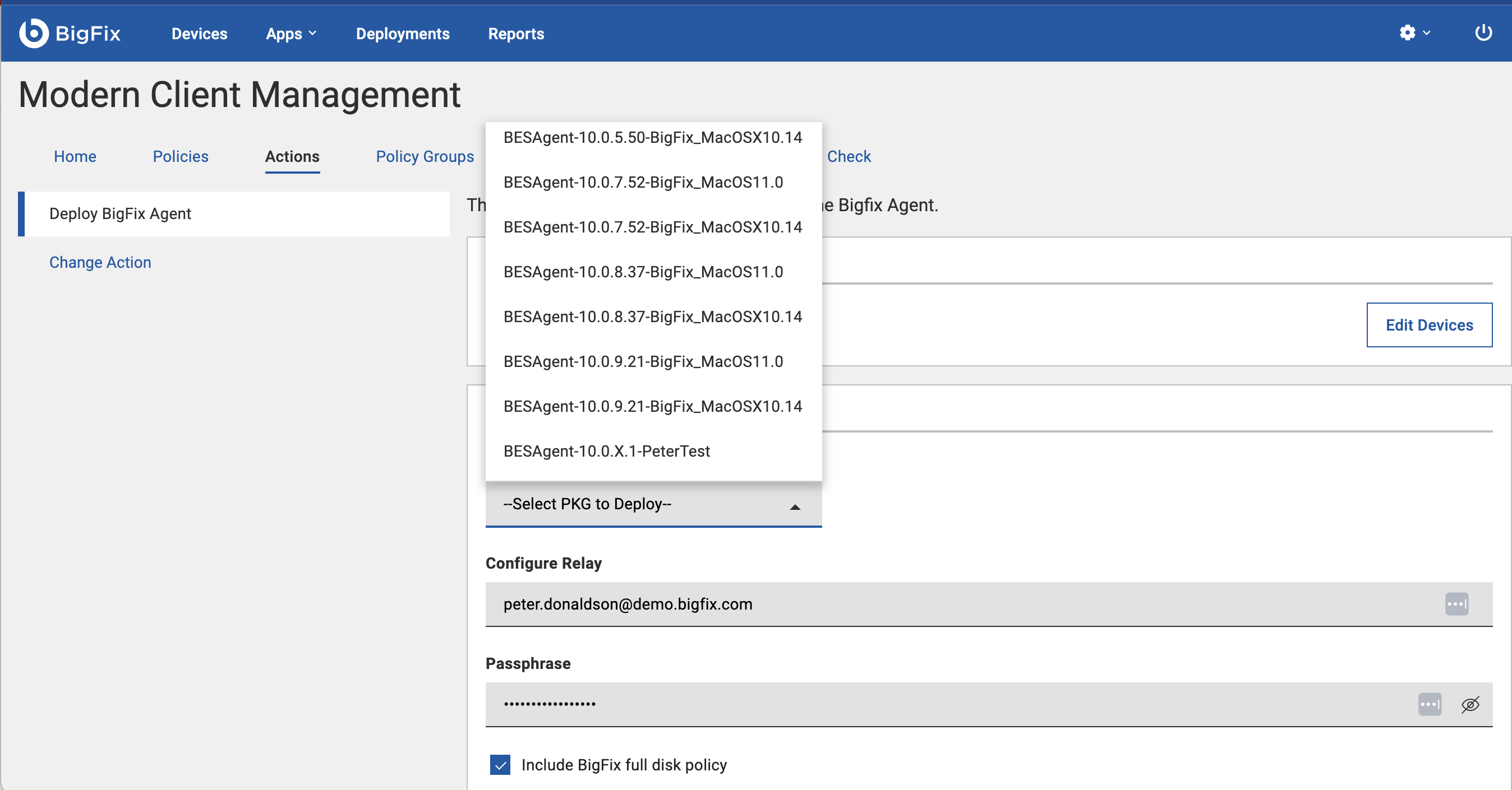

- While deploying BigFix Agent, the available packages list does not show the
latest packages.
- Getting a warning when trying to deploy the BigFix agent, even after
prestaging the BigFix Installer in MDM server.

- For macOS deployments, manually copy any
.plistand.pkgfiles from/var/opt/BESUEM/packagesdirectory to the/var/opt/BESUEM/packages/macOSsubdirectory. - Ensure the analysis
Apple Modern Client Management MDM Serversis correctly configured to point to/var/opt/BESUEM/packages/macOS.

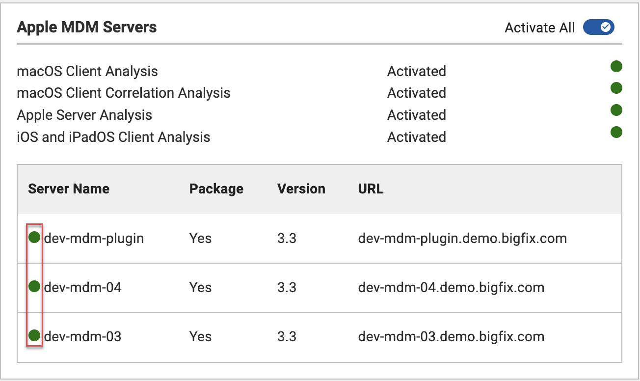

- Verify the WebUI health check at
to ensure all MDM servers show a green light and the associated analyses are activated.https://<webUI Host>/mdm/next/healthcheck
