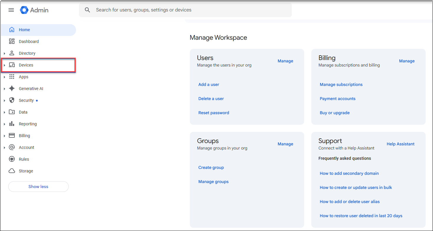

  1. Go to http://admin.google.com and login with admin credentials).

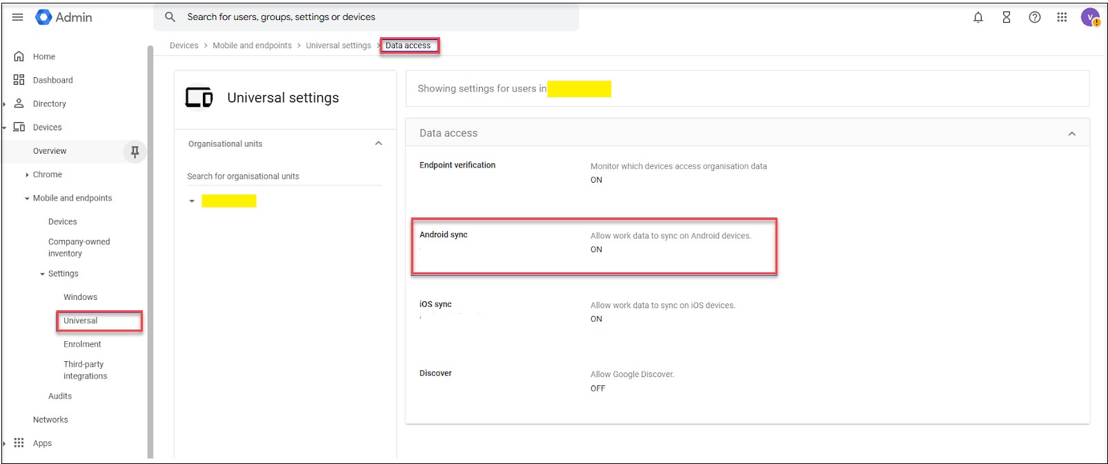

  2. From the left side menu, select devices options

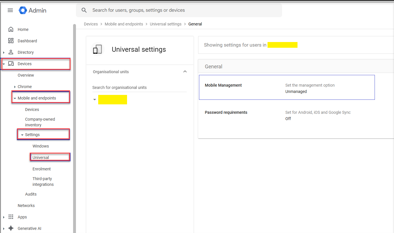

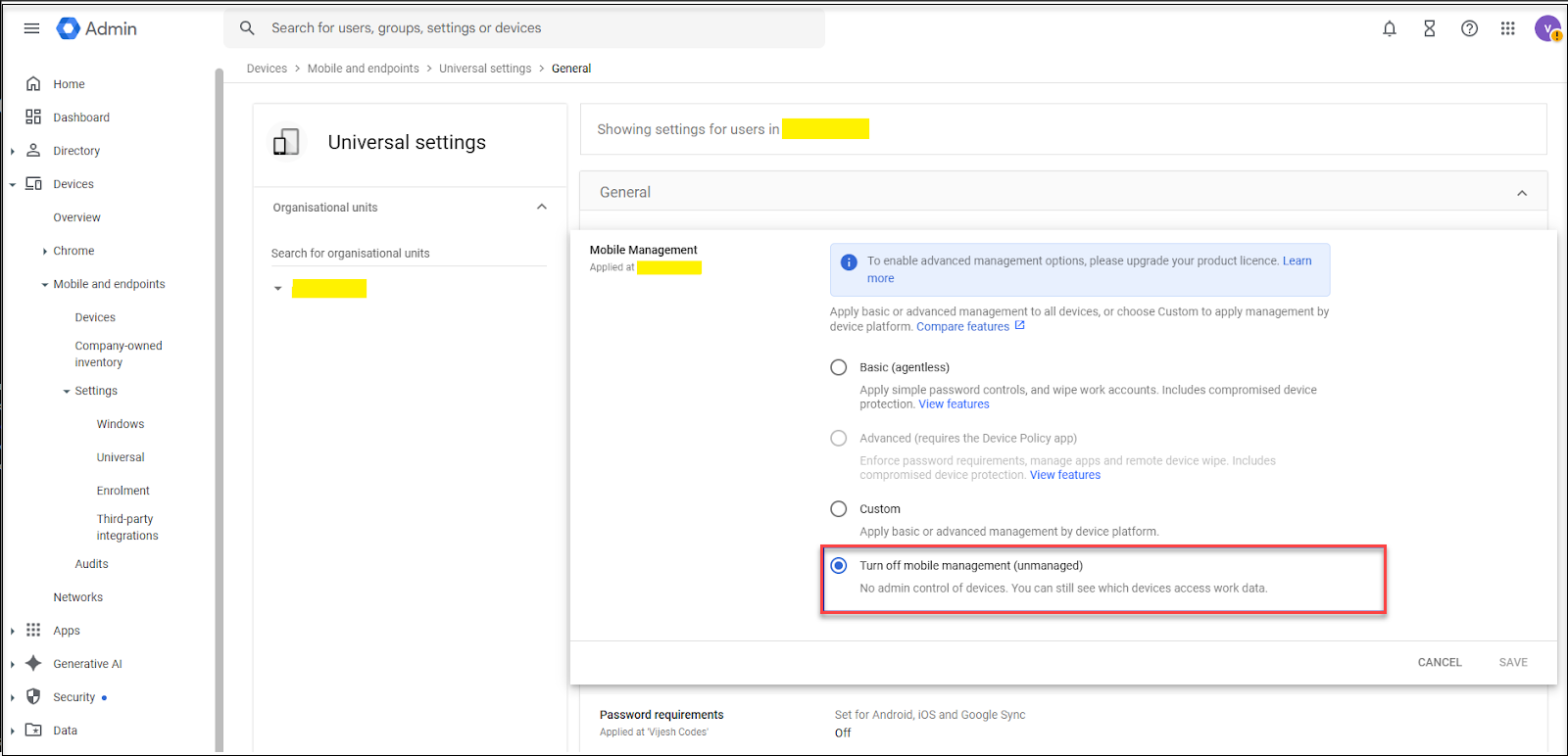

  3. Select the Universal Settings: Navigate to (Devices > Mobile and endpoints > Settings > Universal and select Mobile management.
  4. In the Mobile Management option, select the Turn off mobile management.

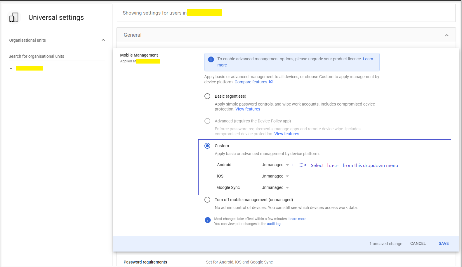

  5. Optional: If you have preferences for which device platforms need to be managed by Endpoint Central, then navigate to Custom and select Android and then from the dropdown menu, select Basic.
  6. In the Universal Settings, click on Data Access and turn on Android sync.

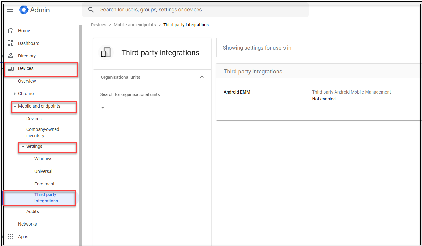

  7. Go back to Settings and select Third-party integrations.
  8. Enable the third party integration and select the registered Enterprise ID or come back to this page once the enterprise registration is completed by using Customer managed mode.

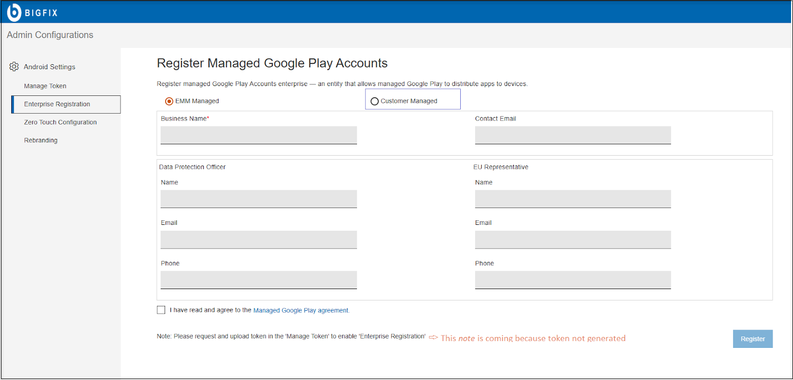

Prerequisites: Ensure that you have created and uploaded the token from MCM server’s configuration page.

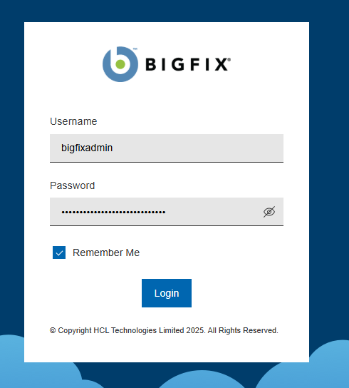

  1. Go to MCM server configuration (https://<mcm_server_ip_or_dns>/config) page by login into the configuration page by using admin credentials.

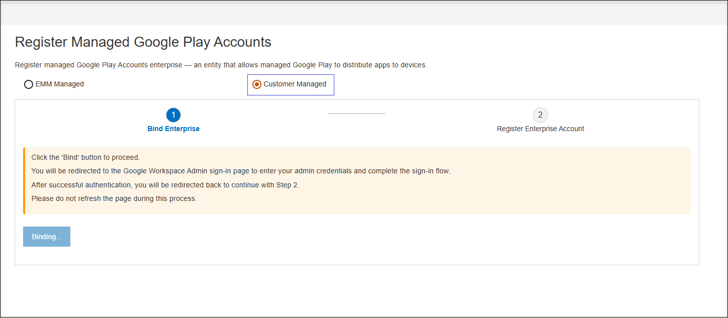

  2. Select the Customer Managed option.

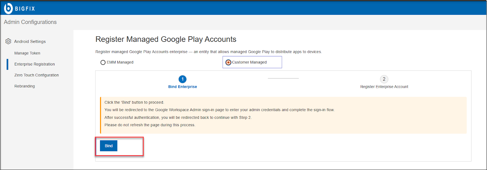

  3. Read the warning and then click on Bind button to initiate the process.

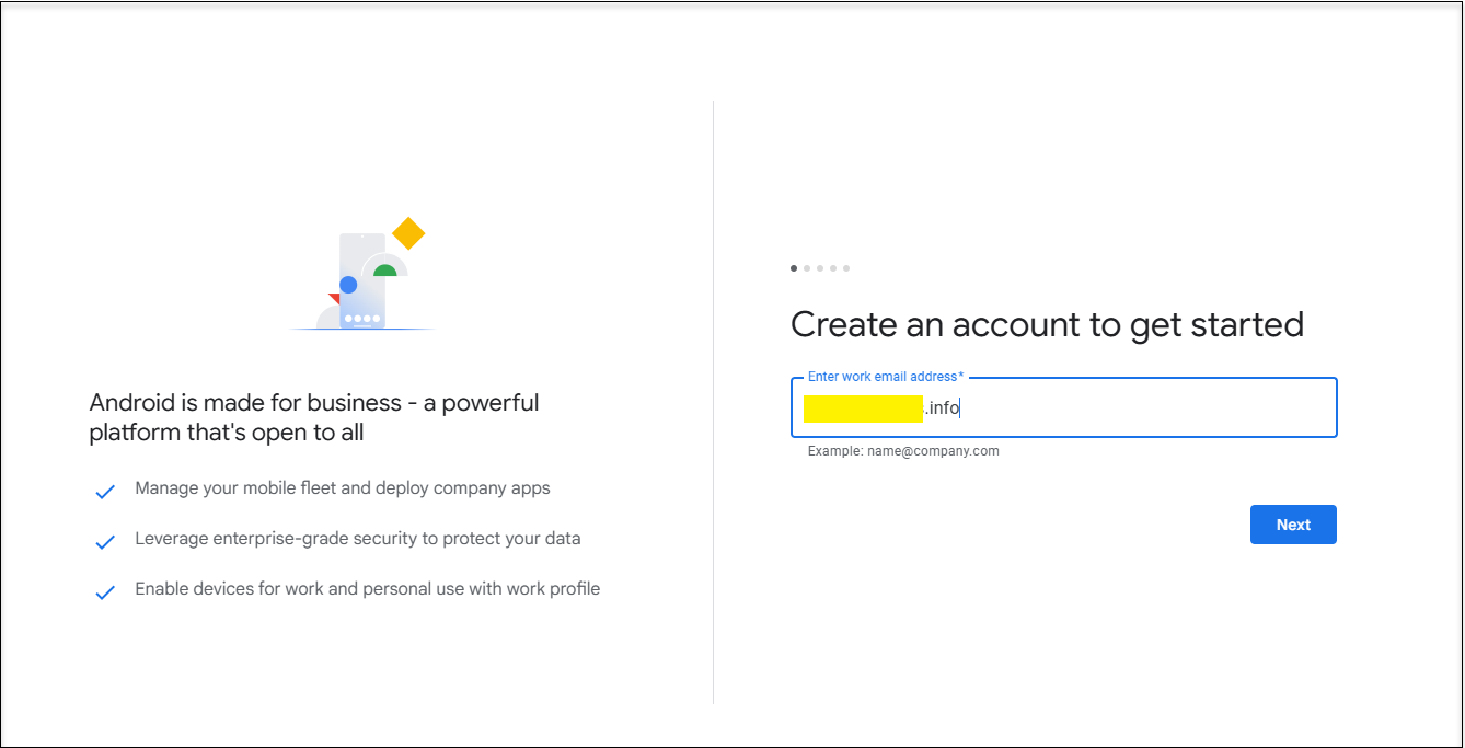

  4. Wait for the binding to complete and redirect to the GSuite authentication page.
  5. Give username and password and complete the GSuite authentication.

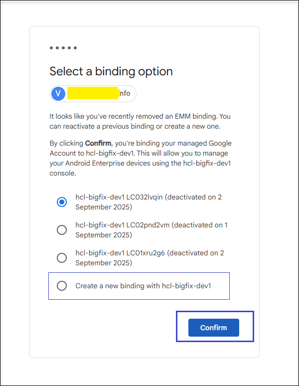

  6. After successful authentication, you will be taken to a page where you can either create or select enterprise IDs.
    If this is your first time, choose Create a new bindingand then click on Confirm button.
    You are seeing the Select option because multiple enterprise IDs have already been created and deactivated for this GSuite account.

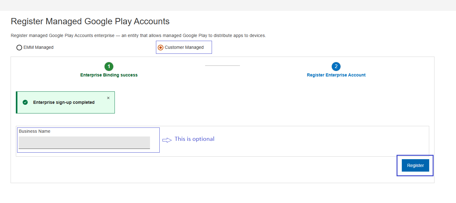

  7. After clicking the Confirm button, you will be redirected back to the MCM configuration’s Enterprise Registration page. Enter a business name if needed (this field is optional). If left blank, your G Suite business name will be used by default. Then click Register to continue with the enterprise registration.
    Note: The registration process may take some time, so please wait. If it fails, try clicking the Register button again after 5–10 seconds.

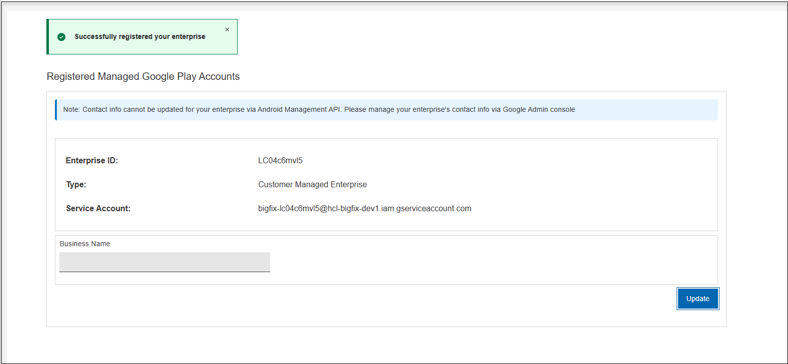

  8. Once registration is completed, you can update the Business Name, if you wish to change.
