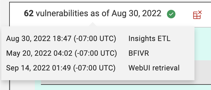

Hover the mouse over the vulnerability list count to see the dates and times updated upon the most recent WebUI retrieval.
The date in the vulnerability list count indicates the Insights ETL or BFIVR date, depending on which is the most recent. It is recommended to have Insights ETL run to completion first and then run an IVR ETL for the most up to date information.
  • Insights ETL is the time of the most recent and successful completion of an Insights ETL. These are determined by the schedules that are setup under Insights. Refer to the link for more information about how to schedule an Insights ETL.
  • BFIVR is the time of the most recent and successful completion of an IVR ETL. These are determined by the schedules that are setup upon deployment of the IVR. Refer to the link for more information about IVR ETL scheduling.
  • WebUI retrieval is the time of the most recent retrieval of IVR data from the broker. By default, WebUI will attempt to pull data daily via the IVR broker. Refer to the link to view IVR settings that can change the frequency of this retrieval. This is also when WebUI updates the Insights ETL and BFIVR times with the latest metrics.

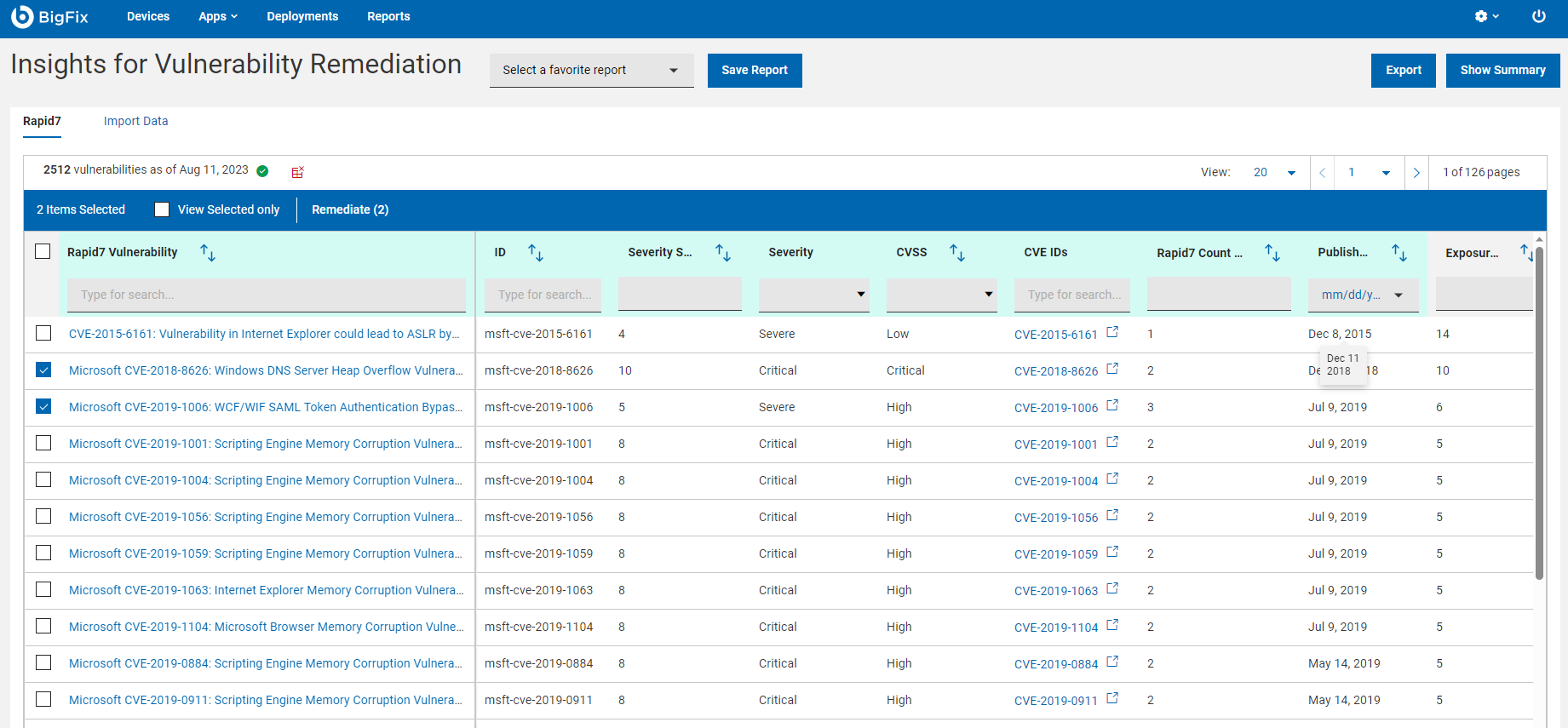

The IVR App contains the following elements:
  • Action bar: Select one or more vulnerabilities from the data grid to enable the action bar.
    • View Selected only: Select the checkbox to view only the selected vulnerability.
    • Remediate: Click Remediate to navigate to the Take Action dialog, where you can remediate the vulnerability. The number in the parenthesis indicates the number of selected vulnerabilities. For more information, see Take Action: The Deploy Sequence.
  • Filters
    Note: Filters in the IVR grid view are presented in green and gray. Green means that information comes from Qualys/Tenable/Rapid 7. Grey colour means that information comes from BigFix Enterprise (BFE) database.
    You can use filters in the headers to refine results:
    • VPR Score: Vulnerability priority rating score.
    • VPR: Vulnerability priority rating.
    • Severity: Vulnerability severity level.
    • CVSS: Common vulnerability scoring system.
    • CVE IDs: Use the CVE ID filter to search for vulnerabilities by Common Vulnerabilities and Exposures.
    • Published: Published date.
    • Scanner Count: Tenable/Qualys/Rapid 7 count - shows the number of vulnerable devices that Tenable/Qualys/Rapid 7 identified with correlated BigFix content.

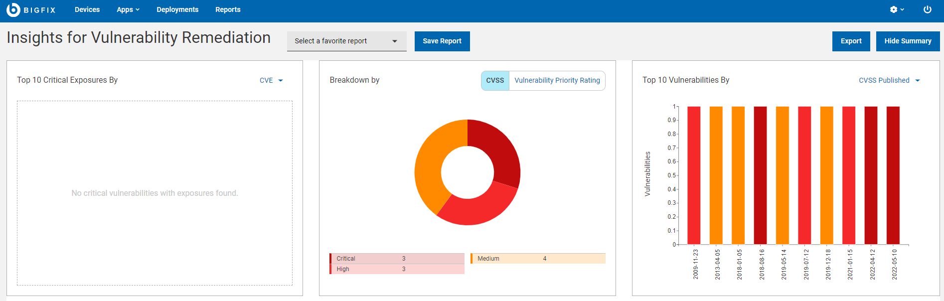

  • Show Summary:
    1. On the IVR page, select the required filters.
    2. Click Show Summary. You can view the summary of all the filtered vulnerabilities as charts and tables. Hover over of the chart to get more details about a data point and the percentages. Hover over any truncated labels to see the full text in the tooltip. You can change filters or enter search text and the report dynamically displays the relevant information.
      • Top 10 Critical Exposures by CVE/Vulnerability ID
      • Breakdown by CVSS/Vulnerability Priority Rating
      • Top 10 Vulnerabilities by CVSS Published Date/Vulnerability Priority Rating Published Date

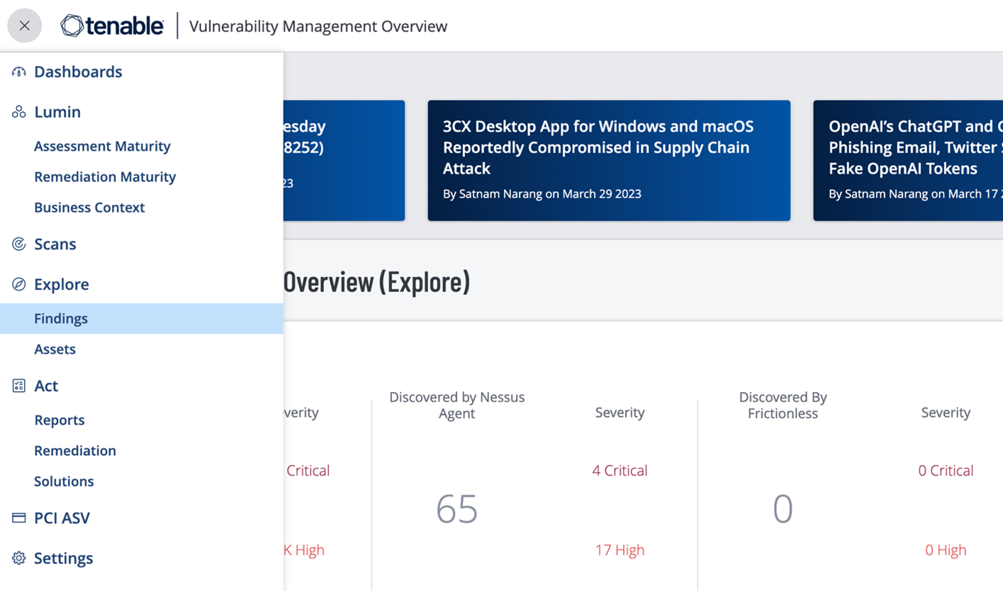

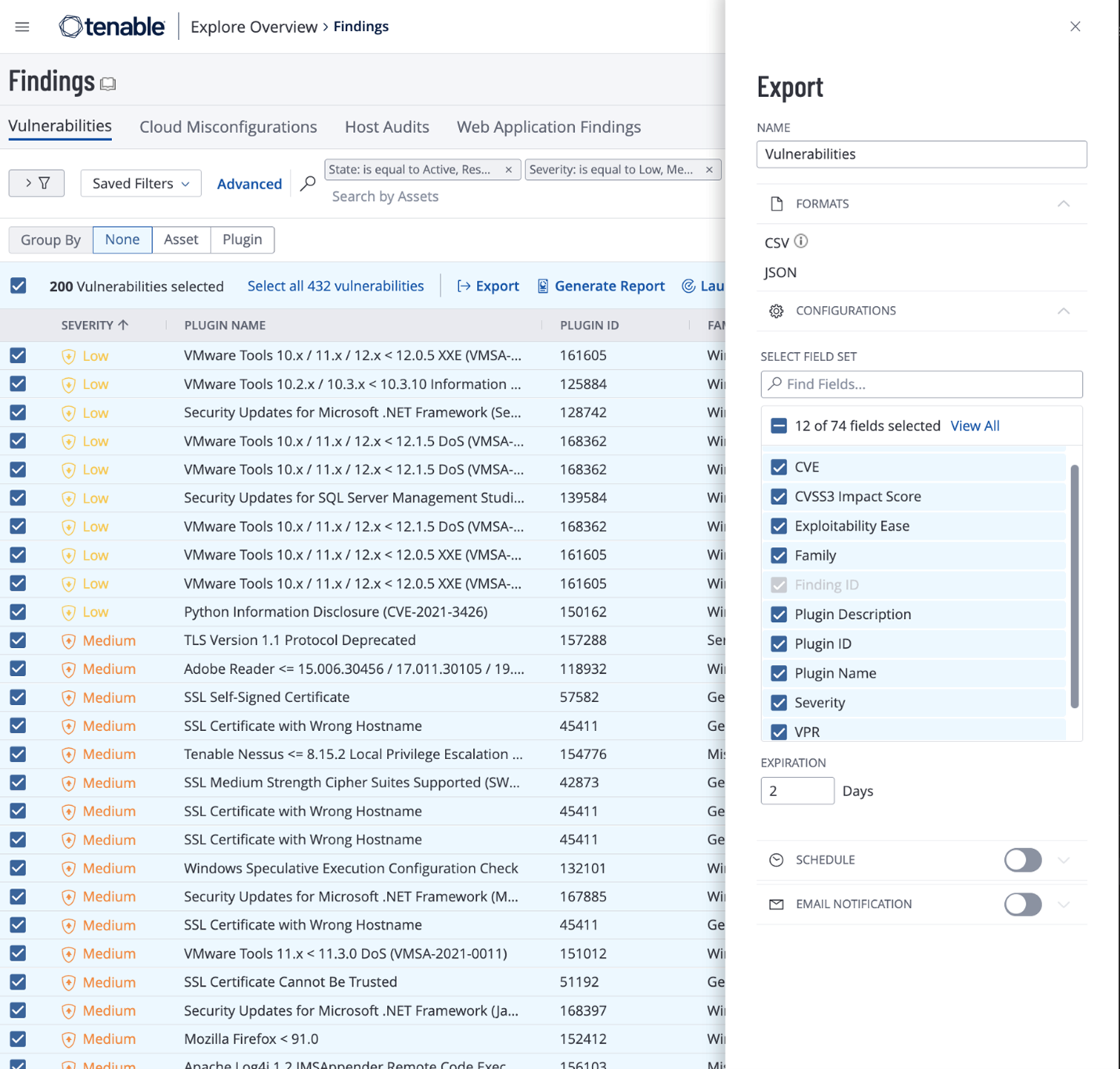

    Tenable:
    1. Open the sidebar and click on Findings under the Explore header.
    2. Apply any necessary filters to the table. Ensure that the Group by option is set to None. When ready, click Export.
    3. Under Configurations, select the following fields: Asset ID, CVSS3 Impact Score, Exploitability Ease, Family, Plugin Description, Plugin ID, Plugin Name, Severity, VPR, Vulnerability Published.

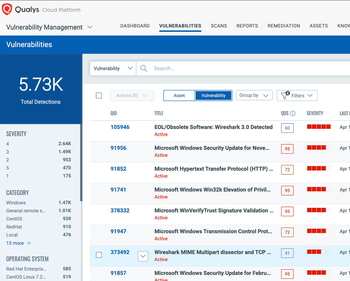

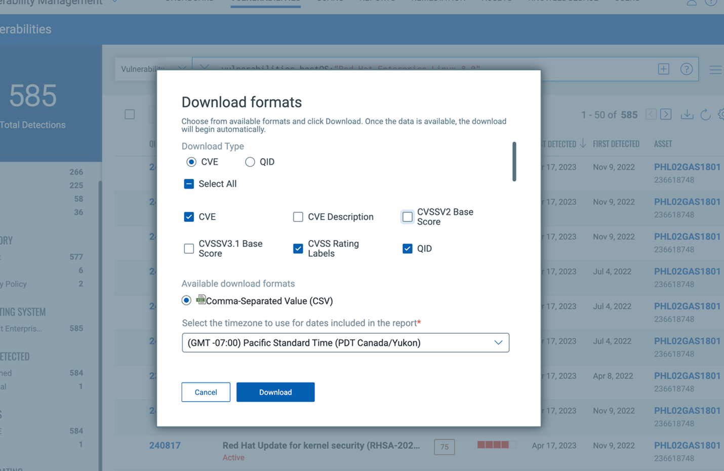

    Qualys:
    1. Navigate to Vulnerabilities and apply any necessary filters. Ensure that Vulnerability is selected and do not select any options under Group by.
    2. Click on the Download icon. When the download popup appears, make sure to select CVE as your Download Type.
      You may choose to Select All or select individually following fields: CVE, CVSS Rating Labels, QID, Title, KB Severity, Severity, Solution, Asset ID, Published Date, Threat, Category.
    3. Click Download.
    Note: If the exported CVEs appear to be in UTF-16 format, open the file in Excel and resave it as a CSV in UTF-8 format.

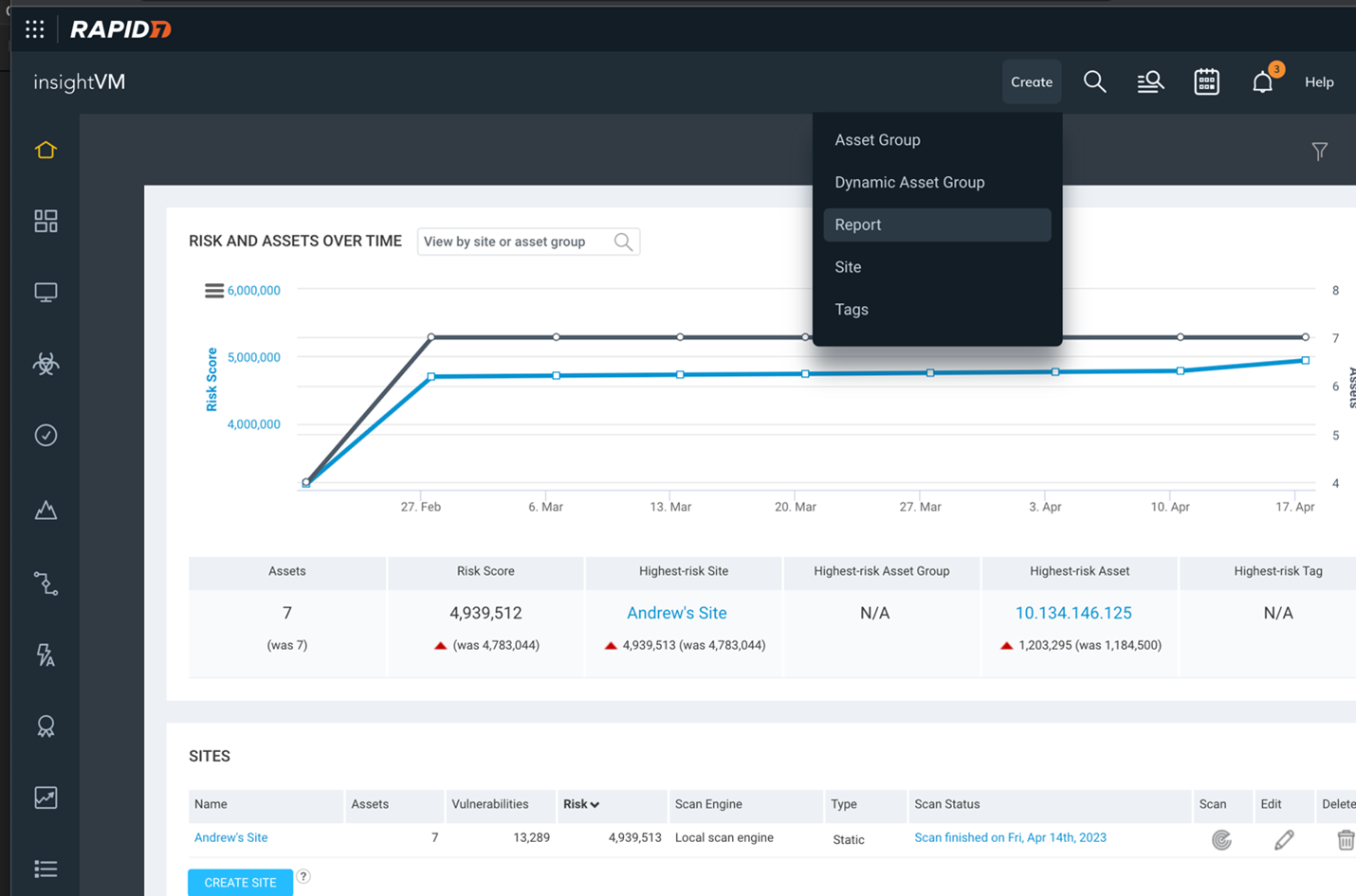

    Rapid 7:
    1. Go to the Rapid 7 Scanner and click on Create > Report.
    2. Click on Manage Report Templates and select new.
    3. Provide a name and description for the template. For template type, select Export (CSV format). Under Content, select the following fields: Vulnerability Title, Vulnerability Tags, Vulnerability Severity Level, Vulnerability Published Date, Vulnerability ID, Vulnerability Description, Vulnerability CVSS Score, Vulnerability CVE IDs, Asset ID
    4. Click Save.
    5. Select Create a Report. Under Template, choose the report template you just created. For File format, select CSV and set the scope as desired.
    6. Click Save & Run the report.

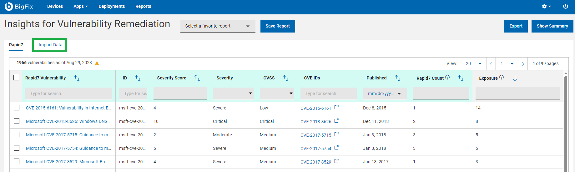

  • Importing CSV format reports into IVR: Import Data
    IVR app enables users to import Qualys, Tenable, Rapid 7, or generic reports in CSV format directly into IVR.
    Note: Data Import is available for all users who have access to the IVR app. Please be aware that the WebUI IVR platform supports the import of one CSV file at a time. All users of WebUI IVR, regardless of their roles or permissions, share the responsibility for managing imported CSV reports. This means any IVR user has the ability to both view and delete the imported CSV reports.

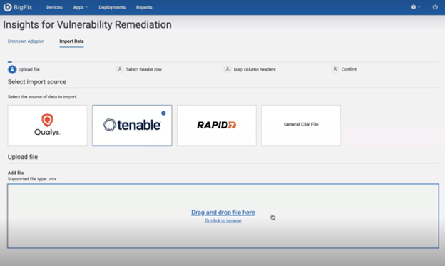

    1. Select Import Data tab in IVR app.
    2. Select the import source: Qualys, Tenable, Rapid 7, or generic CSV file and upload the file. The IVR app will initiate the import process.

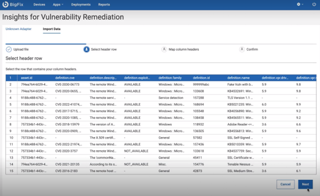

    3. Select header row that contains your column header.

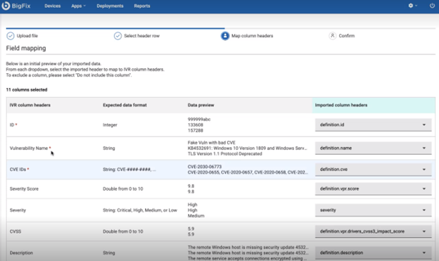

    4. Map column headers. From each dropdown select the imported header to map the IVR column headers. To exclude a column, select “Do not include this column” from the dropdown list.
      IVR column header includes following elements:
      IVR Column Header Requirement List HCL Note Specific Definition
      ID Must have for CSV import ID of vulnerability
      Vulnerability Name Must have for CSV import Name of vulnerability
      CVE IDs Must have for CSV import unique identifier for vulnerability (Ex : CVE-2023-35644)
      Severity Score Optional It helps prioritize vulnerabilities for action based on their severity levels: Critical, High, Medium, or Low
      Severity Optional Range given to vulnerability how priority is this
      CVSS Optional intrinsic risk of the a vulnerability across the system
      Description Optional Description about the vulnerability
      Published Optional Date on which vulnerability is found
      Exploitability Optional How easily a vulnerability is exploited(Ex : attack vector, user interaction)
      Product / Family Optional The Plugin/ Family describe how vulnerability and fixlets are mapped
      Asset ID Strongly recommended for CSV import unique assets associated with each vulnerability

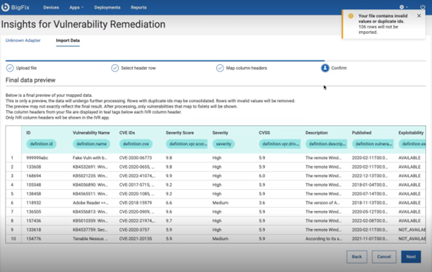

    5. IVR app will present a summary of the imported data for your review. Verify the accuracy of the information before finalizing the import. Click Next.
    6. Once confirmed, the IVR app will integrate the vulnerability report into its database. The imported data will now be accessible for analysis and reporting within the IVR system.

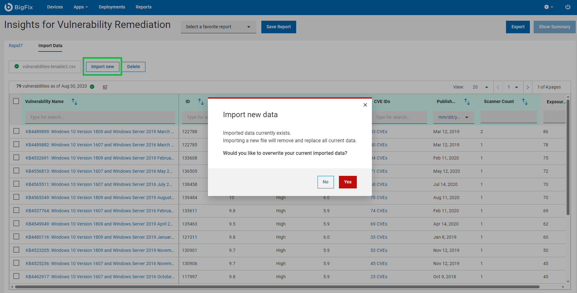

  • Delete CSV report
To delete the report, click Delete and confirm deletion. Deleting a file will remove all current data from IVR.
  • Import new CSV report
To import new report, click Import new. Importing a new file will remove and replace all current data.
