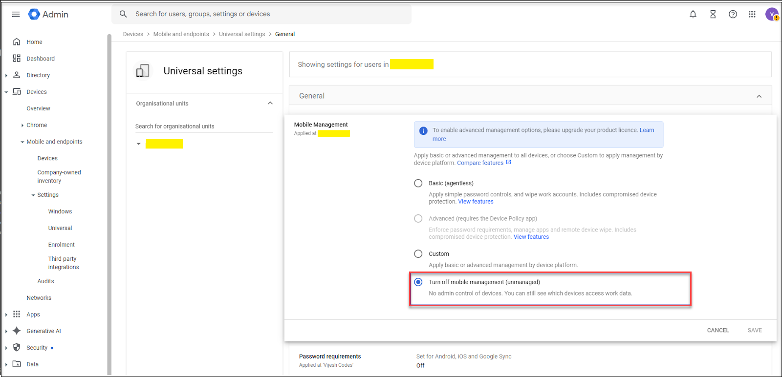

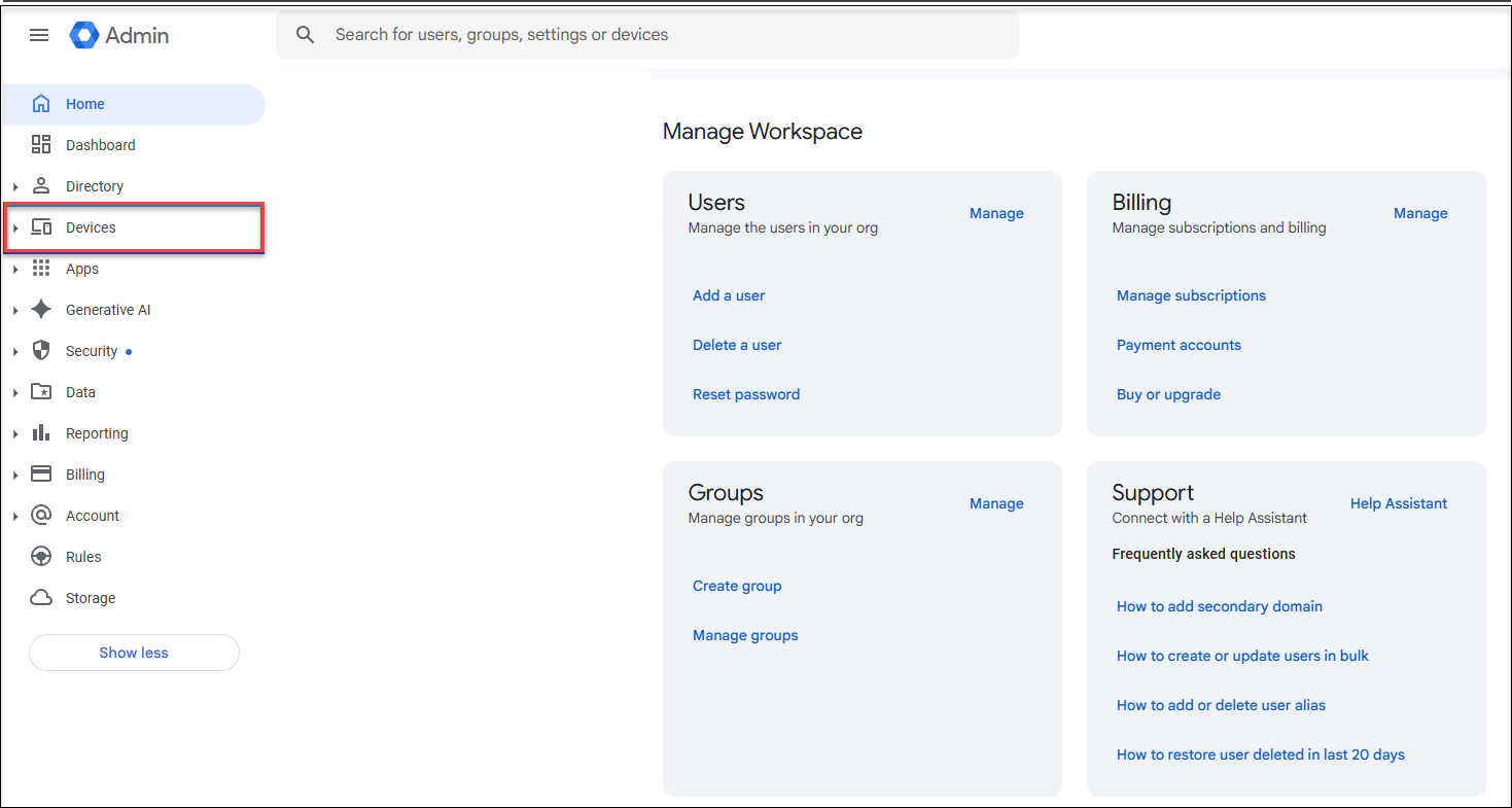

- Go to
http://admin.google.comand login with admin credentials). - From the left side menu, select devices options

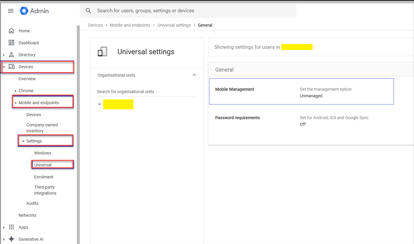

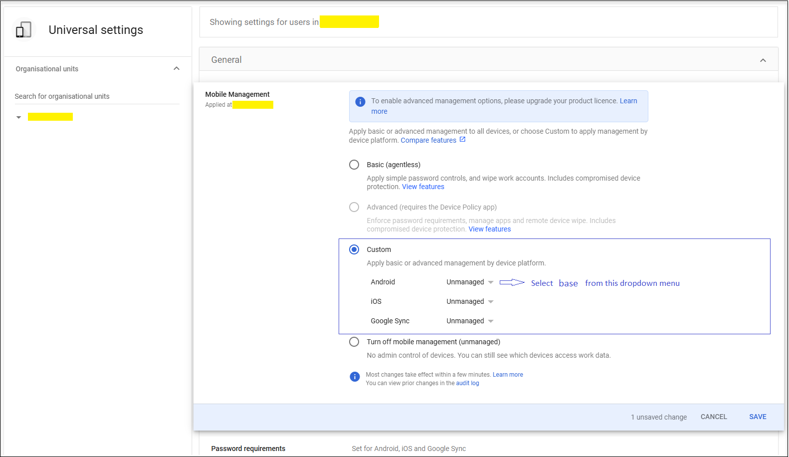

- Select the Universal Settings: Navigate to ( and select Mobile management.
- In the Mobile Management option, select the
Turn off mobile management.
- Optional: If you have preferences for which device platforms need to be managed
by Endpoint Central, then navigate to Custom and select
Android and then from the dropdown menu, select
Basic.

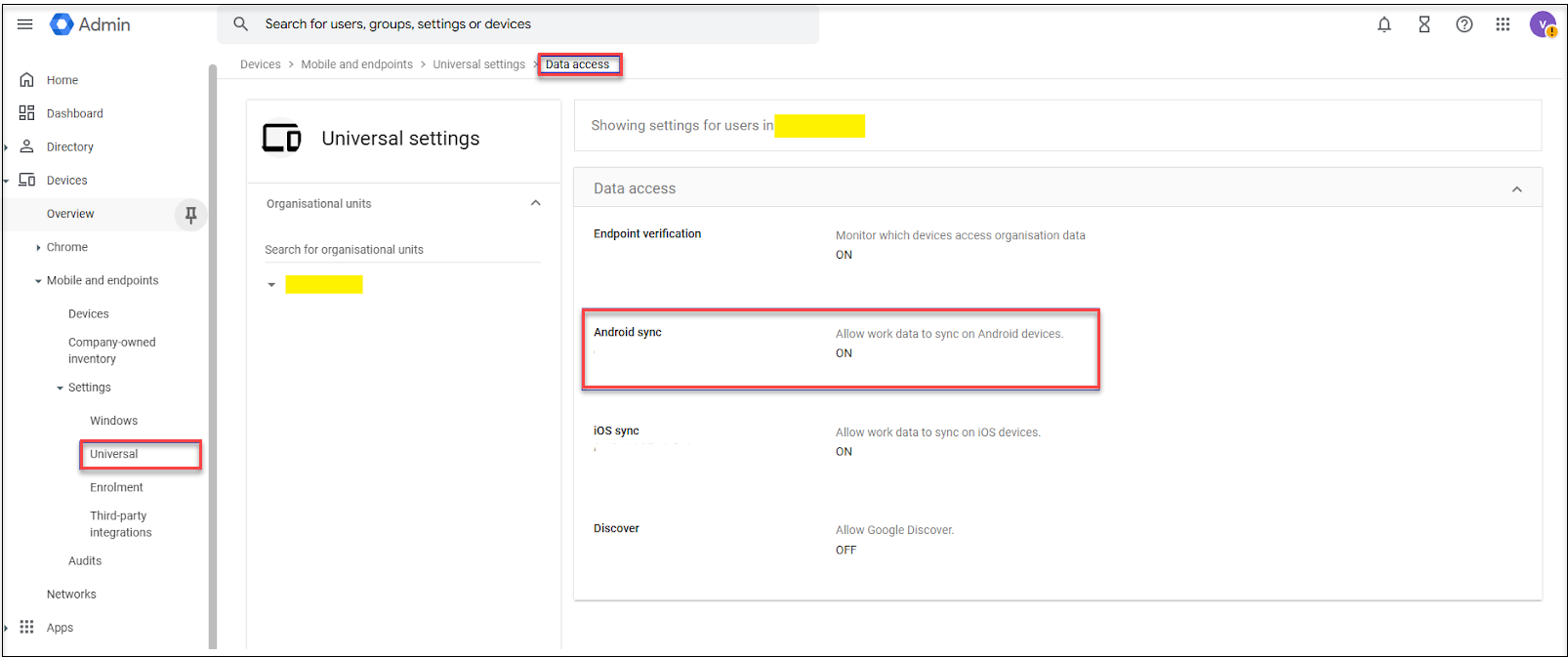

- In the Universal Settings, click on Data
Access and turn on Android sync.

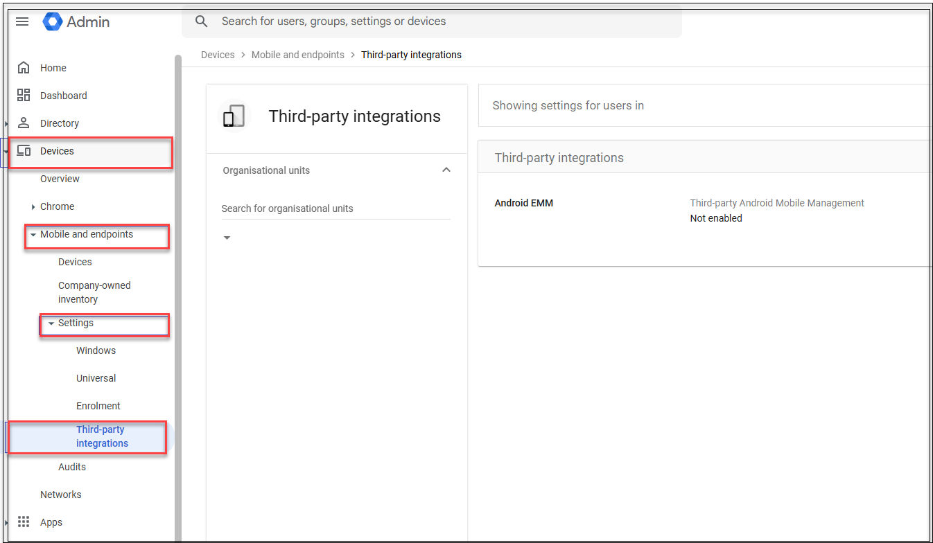

- Go back to Settings and select Third-party
integrations.
- Enable the third party integration and select the registered Enterprise ID or
come back to this page once the enterprise registration is completed by using
Customer managed mode.

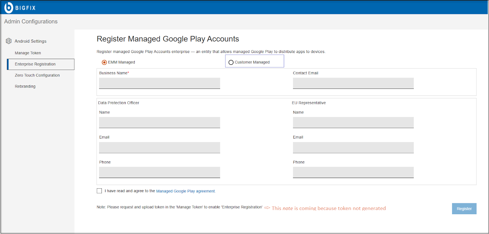

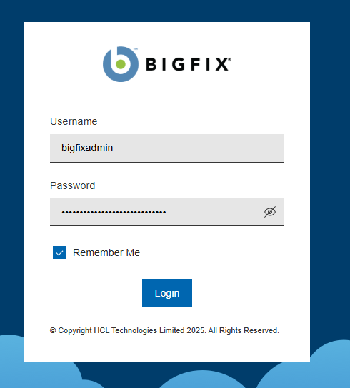

Prerequisites: Ensure that you have created and uploaded the token from MCM server’s configuration page.

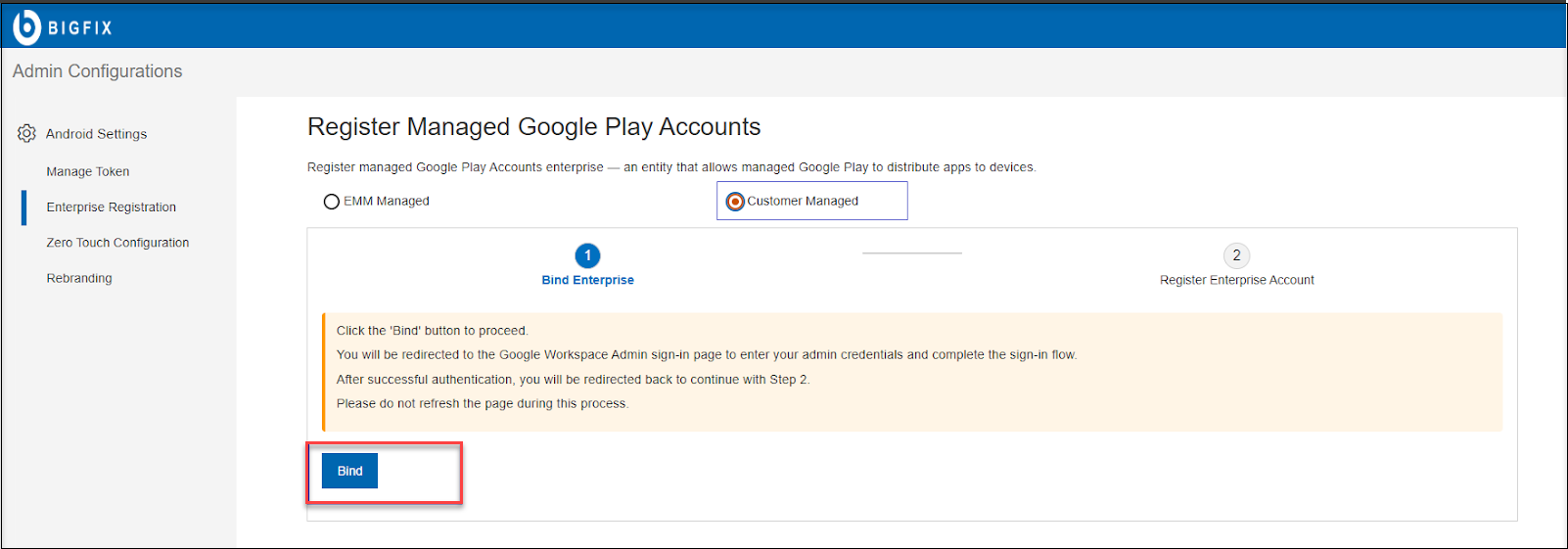

- Go to MCM server configuration (https://<mcm_server_ip_or_dns>/config)
page by login into the configuration page by using admin credentials.

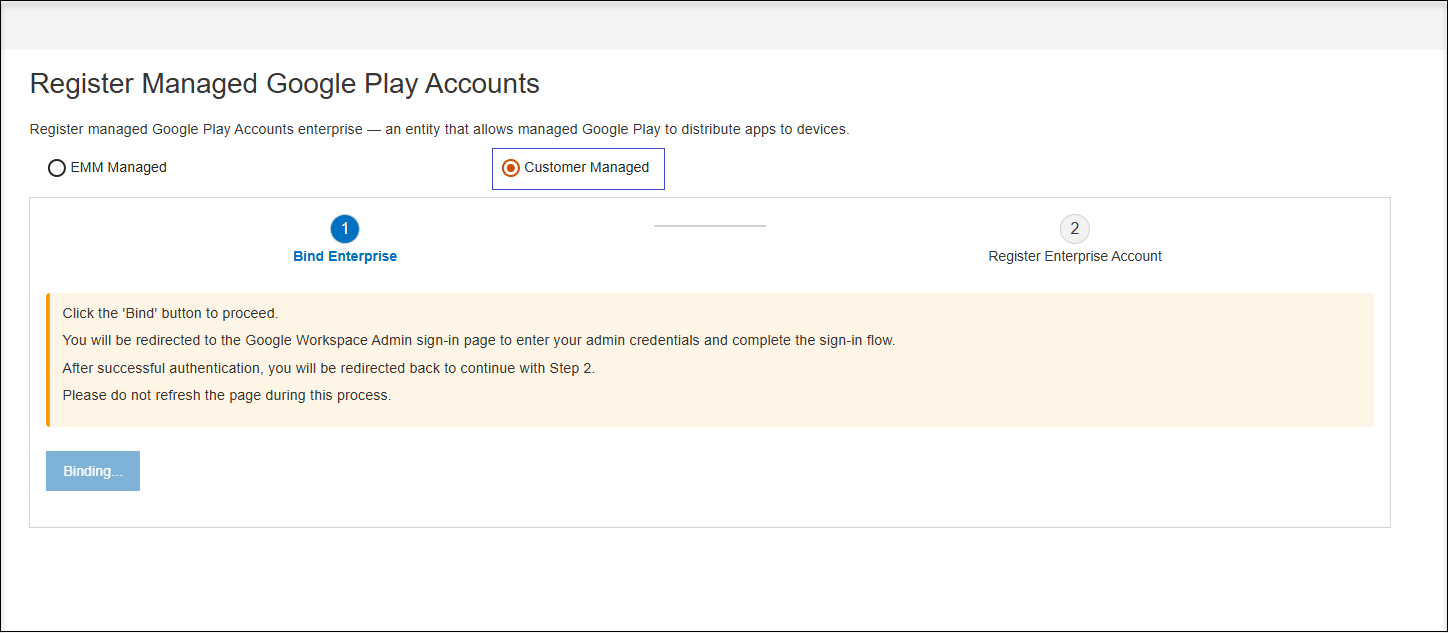

- Select the Customer Managed option.
- Read the warning and then click on Bind button to
initiate the process.
- Wait for the binding to complete and redirect to the GSuite authentication
page.

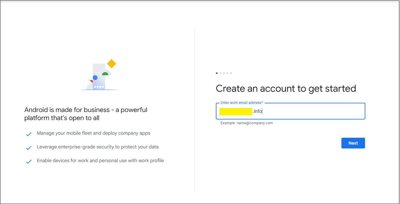

- Give username and password and complete the GSuite authentication.

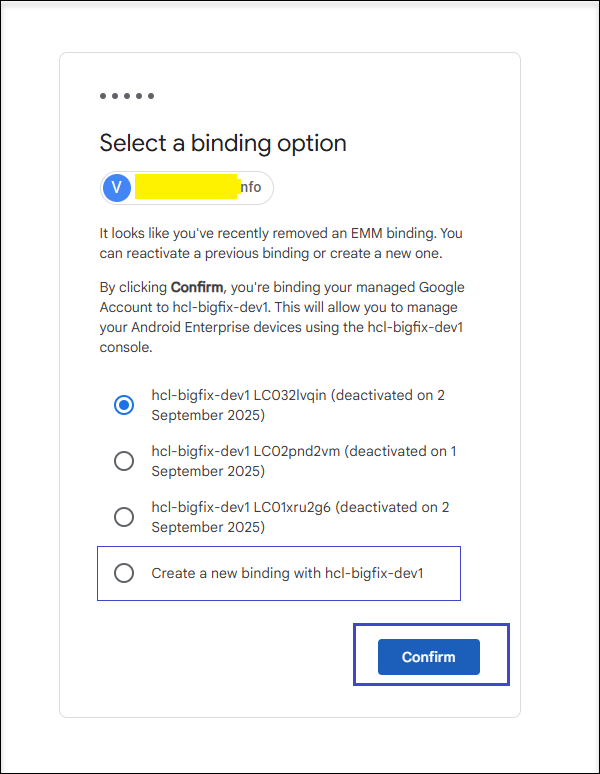

- After successful authentication, you will be taken to a page where you can
either create or select enterprise
IDs.
Note:If this is your first time, choose Create a new bindingand then click on Confirm button.
You are seeing the Select option because multiple enterprise IDs have already been created and deactivated for this GSuite account. - After clicking the Confirm button, you will be

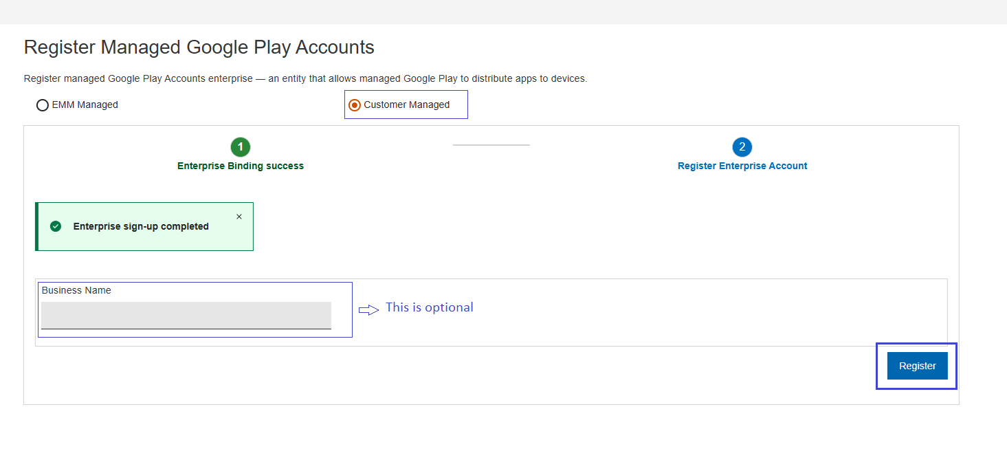

redirected back to the MCM configuration’s Enterprise Registration
page. Enter a business name if needed (this field is optional). If left
blank, your G Suite business name will be used by default. Then click
Register to continue with the enterprise
registration. Note: The registration process may take some time, so please wait. If it fails, try clicking the Register button again after 5–10 seconds.

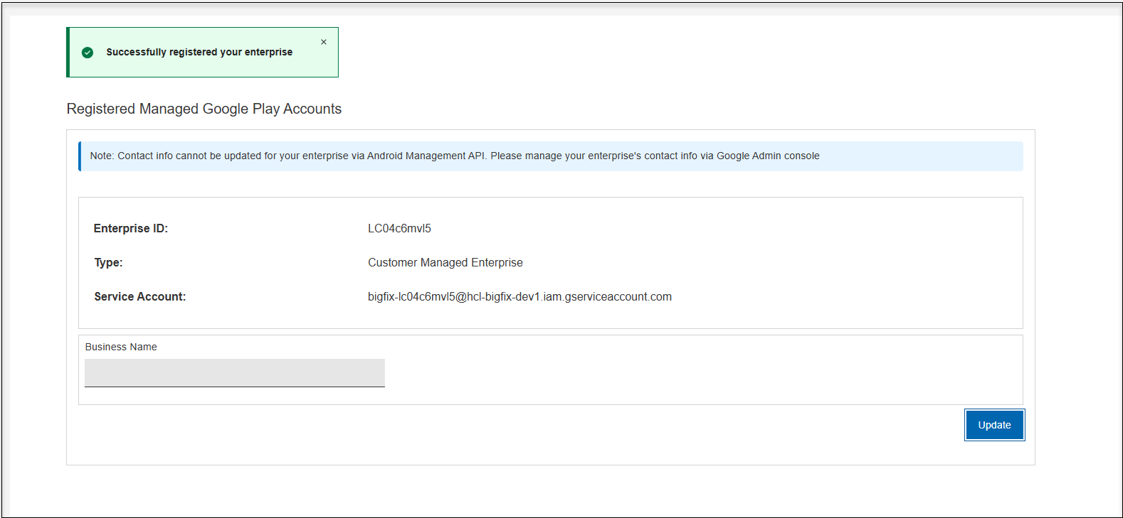

- Once registration is completed, you can update the Business
Name, if you wish to change.
