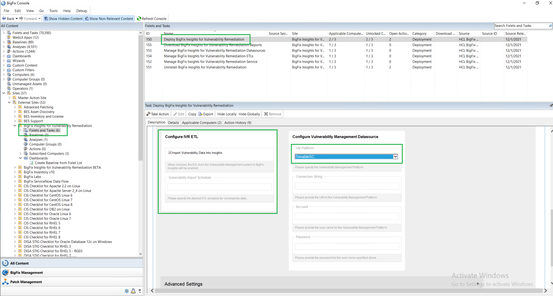

  1. Initial IVR ETL scheduling is made during deployment. Refer to the link to see how to deploy IVR Service and configure ETL.
  2. After you complete the initial configuration of IVR Service, you can configure IVR ETL using Manage BigFix Insights for Vulnerability Remediation ETLs Fixlet.

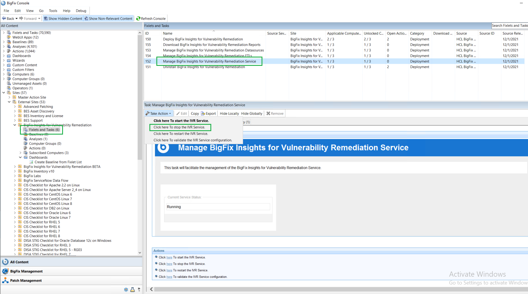

    IVR Service must be stopped to perform this task. To stop the service use Manage BigFix Insights for Vulnerability Remediation Service Fixlet and Take Action on Stop IVR Service.

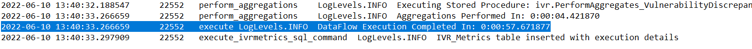

To ensure that dataflow has completed successfully, go to logs folder and open a respective dataflow_*.log file. Check if the following message appears in the file:
execute LogLevels.INFO DataFlow Execution Completed
