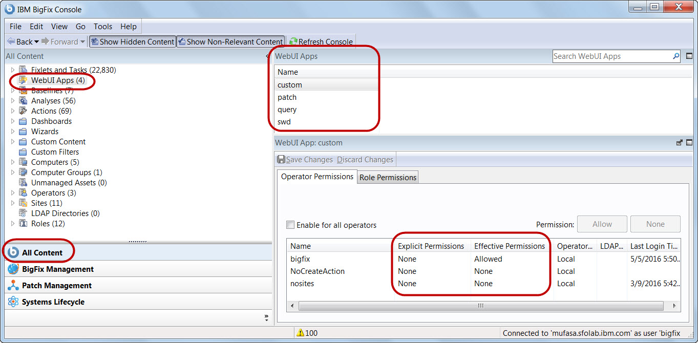

Explicit and Effective Permissions
BigFix and WebUI permissions can be granted directly or indirectly. Permissions that are granted directly to an operator are explicit permissions; permissions that are granted indirectly, for example, through a role, to one or more operators are effective permissions. Both types are shown for each operator and role.
Image highlighting Explicit and Effective permission values.

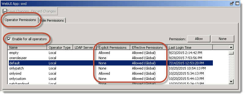

Effective permissions can also be granted using the WebUI's Enable For All Operators check box. When granted using this method the descriptor Allowed, in the Effective Permissions column becomes Allowed (Global).
Image showing Operator Permissions tab and the Enable for All Operators check box.
Conflicts can arise between an operator's explicit and effective permissions. For example, access to the Patch application can be disabled for Operator A, but enabled for a role to which Operator A is assigned. When this occurs BigFix applies the least restrictive of the two settings. And the result is shown in the Effective Permission column.
Explicit and Effective permission values convey information about how and where permission was granted. When there is a conflict, check the Effective Permission column for the true state of the permissions.

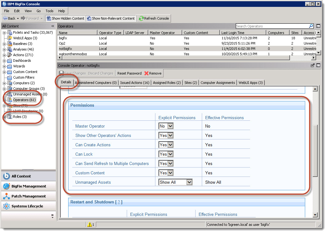

Create Actions Privilege
An operator whose Can Create Actions permission is set to No is not allowed to deploy content, though they can still see deployments made by others. You can use this function to grant a form of read-only access to an operator or role.
To set Create Action permissions to No:
  1. Go to All Content > Operators > Details or All Content > Roles > Details.
  2. Scroll down to the Permissions pane and set Can Create Actions to No.
  3. Click Save Changes.
Image showing the Can Create Actions settings on the Details tab.
