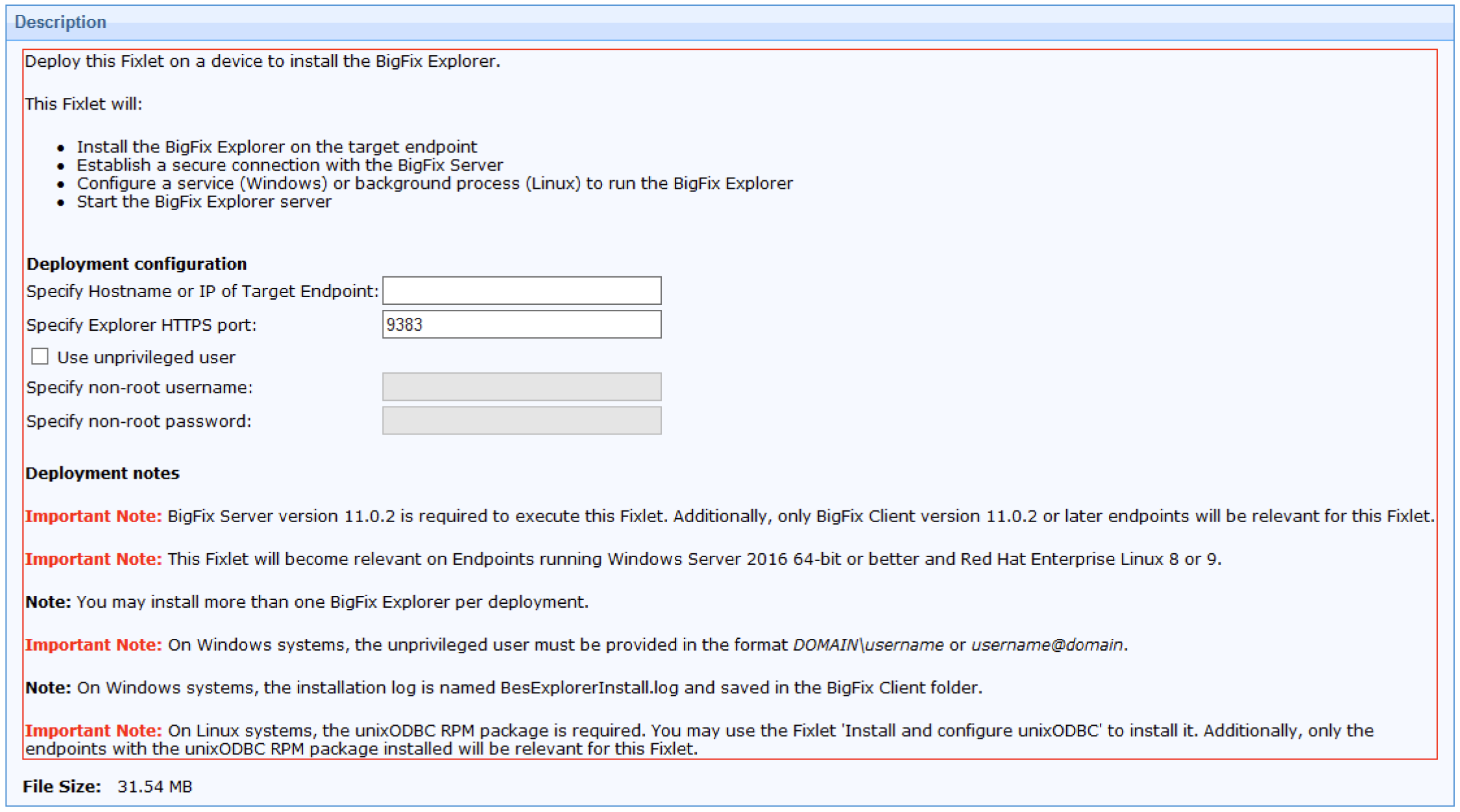

Logged on as a BigFix Master Operator (MO), you will be able to deploy a BigFix Explorer instance in your environment by deploying the Installation Fixlet of the BigFix Explorer, named Install BigFix Explorer (Version 11.0.x), on a target client machine.
In the Deployment configuration section of the Fixlet pane, you must configure the following fields before running the Fixlet:
- (Mandatory) In Specify Hostname or IP of Target Endpoint, enter the hostname or the IP address of the target client computer on which you intend to install BigFix Explorer.
- (Mandatory) In Specify Explorer HTTPS port, enter the HTTPS port that the BigFix Explorer should use to expose its REST APIs. By default, this port is 9383.
- (Optional) Check the box named Use unprivileged user if you want to install BigFix Explorer using a non-administrative user.
- (Optional) If you have checked the box described above, enter the non administrative user ID and password in the fields named Specify non-root username and Specify non-root password respectively.

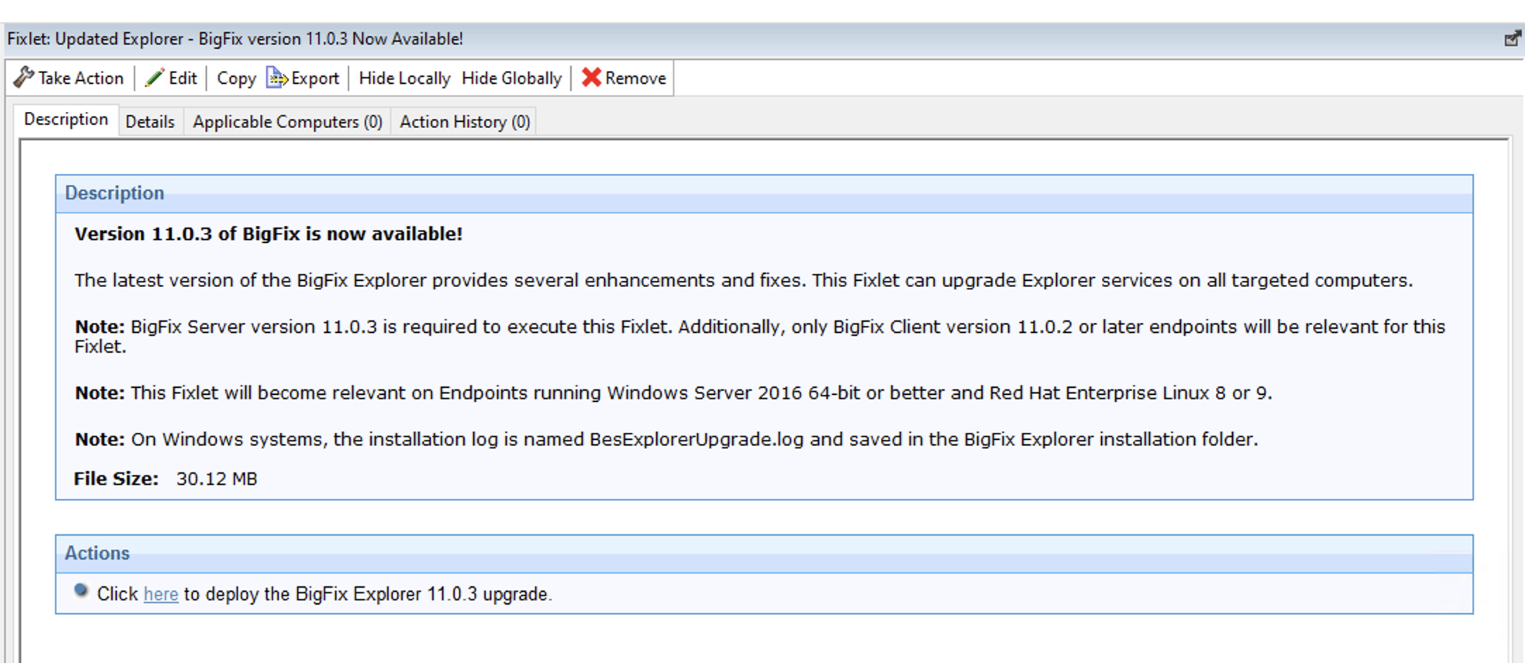

Logged on as a BigFix Master Operator (MO), you will be able to upgrade a BigFix Explorer instance in your environment by deploying the Upgrade Fixlet of the BigFix Explorer, named Updated Explorer, on a target client machine.
