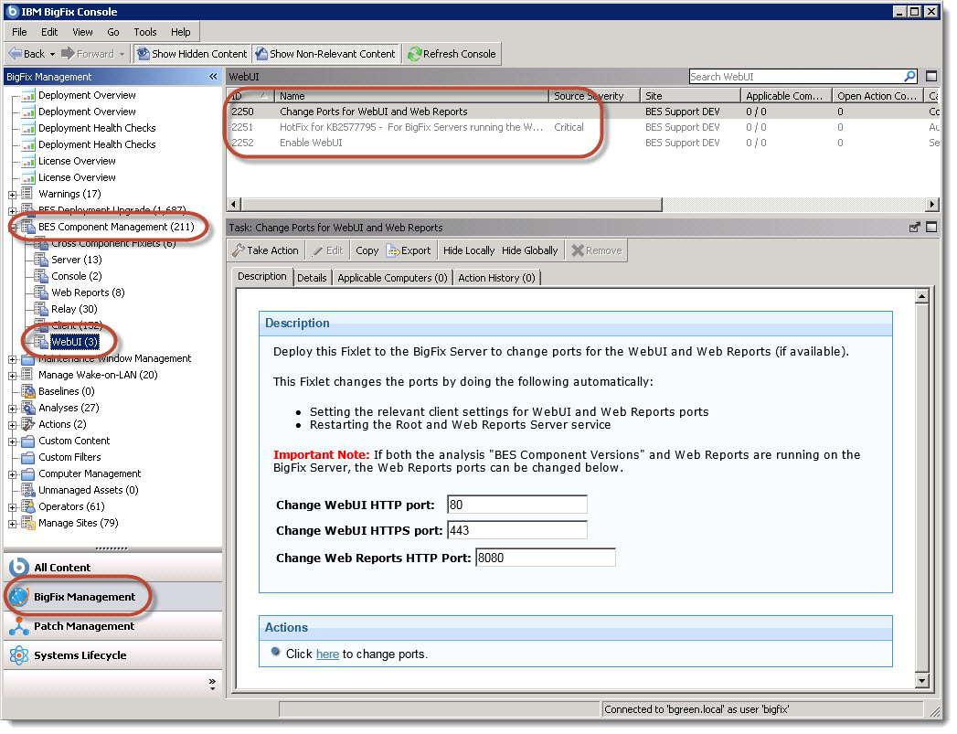

- In the BigFix console, navigate to BigFix Management > BES Component Management > WebUI. Three WebUI enablement Fixlets are available:
- Fixlet 2250 - Change Ports for WebUI and Web Reports
- Fixlet 2251 - Hotfix for KB2577795…

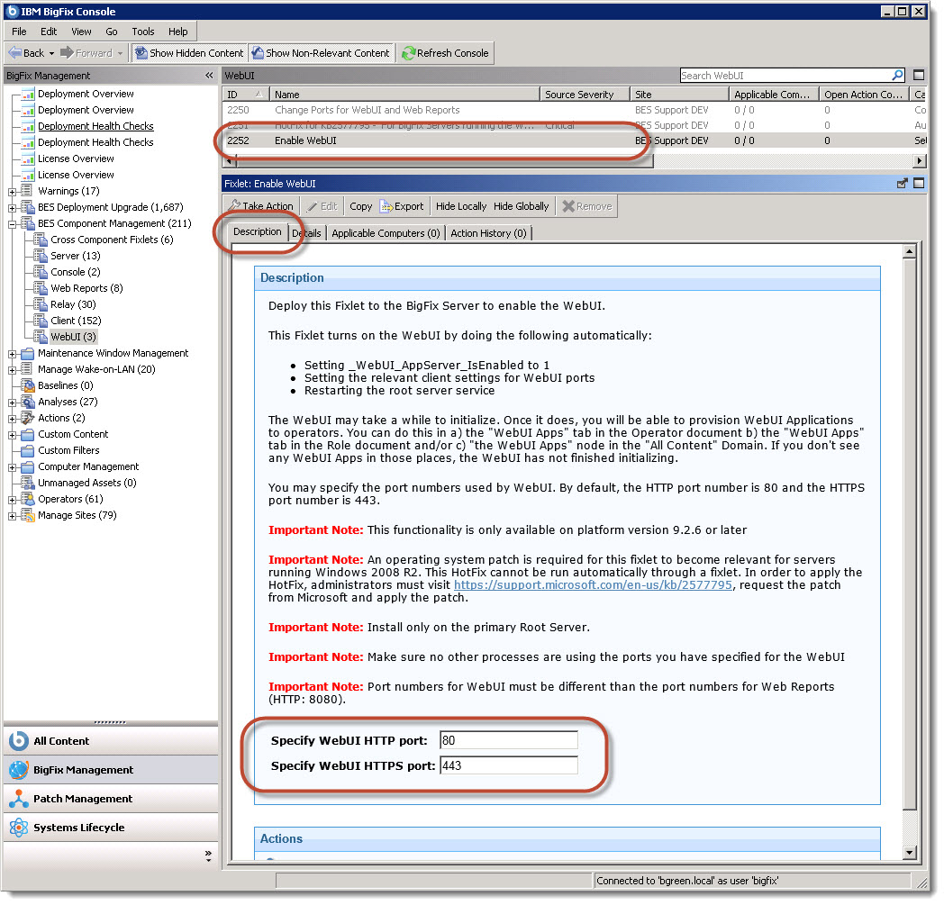

- Fixlet 2252 - Enable WebUI
- Select Fixlet 2252 and view the Description tab of the Fixlet. Here you can select the HTTP and HTTPS ports that are assigned to the WebUI. The defaults are ports 80, and 443.
- Run Fixlet 2252 by selecting Take Action and choosing your primary BigFix server as its target.

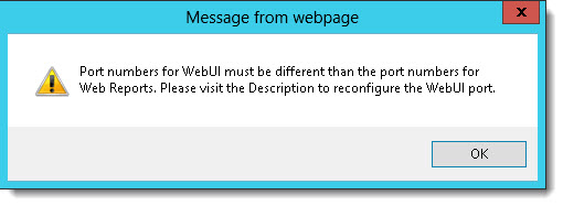

Fixlet 2252 checks for a port conflict with Web Reports, if Web Reports is present. If a conflict is found an error message displays, and the Fixlet stops.
- If a port conflict with Web Reports is detected, run Fixlet 2252 again and choose a different port for WebUI. Even if you plan to change either the Web Reports or WebUI ports, you must choose a non-conflicting port to enable the WebUI. For more information, see Change Communication Ports.

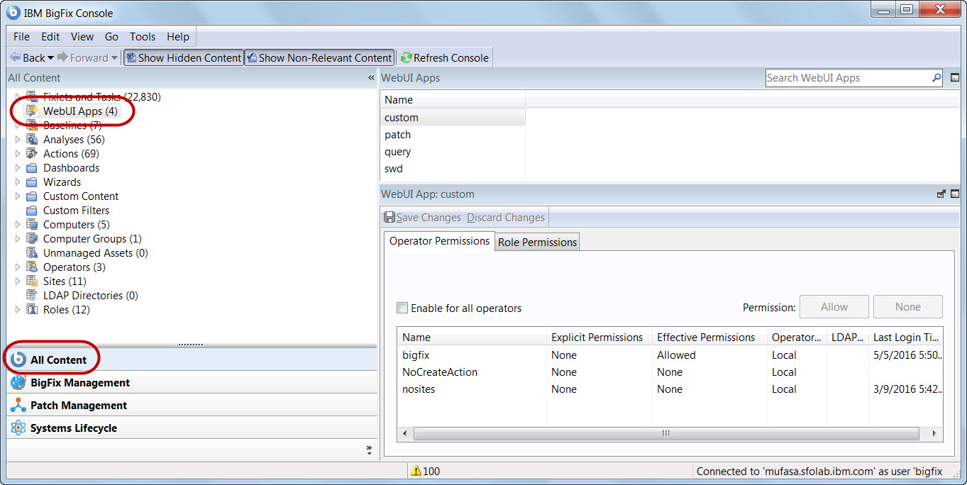

- After the Fixlet has completed by restarting the BesRootServer, WebUI is enabled. To confirm, navigate to All Content > WebUI Apps. If the WebUI Apps menu item is not present, enablement has failed and Fixlet 2252 should be run again. There may be a small delay between enablement and the menu item displaying depending on your deployment.
