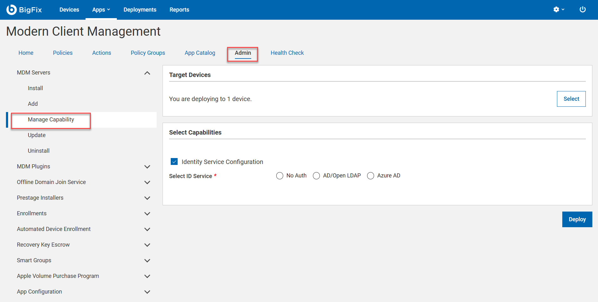

From the WebUI main page, select .
On the Modern Client Management page, click Admin.
On the Admin page, select . The following page appears:
Click Select to select an MDM server on which you want
to configure the identity service.
Identity Service Configuration
Under the Select Capabilities section, select the Identity
Service Configuration checkbox. ID Service options
appear for you to select.
Select ID Service
