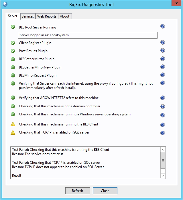

The program analyzes the server components and creates a report. - For more in-depth information, click the Full Interface . The BigFix Diagnostic control panel is
displayed. This window has tabs corresponding to the categories of server diagnostics,
including Services and Web Reports.

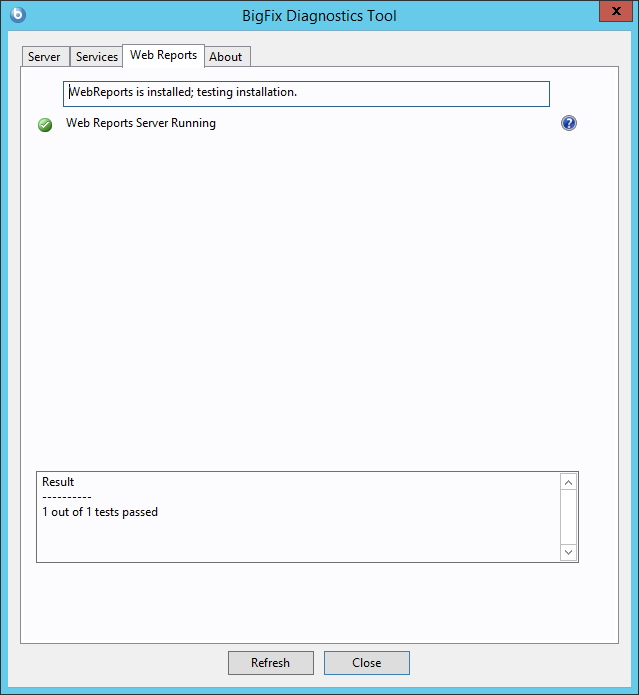

Note: If the messageVerifying that the BESGather service can reach the Internetis displayed after a fresh install and you have a proxy, ensure that you configured it as described in Setting up a proxy connection.If you have not yet installed the client, a warning light is shown. It becomes green as soon as you install the client.

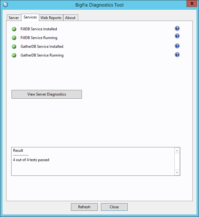

- In the Services tab check if the database and gathering services are correctly
installed and running.
If a red light is glowing next to an item, it indicates a failure of that component. You must address the stated problem before you can be sure that the Server is functioning correctly. Similarly, there is a tab to diagnose the Web Reports server.
- To find out more information, click the question mark button to the right of any item. These buttons link to knowledge-base articles at the BigFix Support Site.
- If all the buttons are glowing green, click Close to exit the Diagnostic.
Note: If the Server computer is a member of a domain, but you are logged in as a
local user, the Diagnostics Tool will sometimes erroneously report that permissions are
incorrect. If you see that your permissions tests are incorrectly failing, you can safely
ignore the diagnostics warnings.
