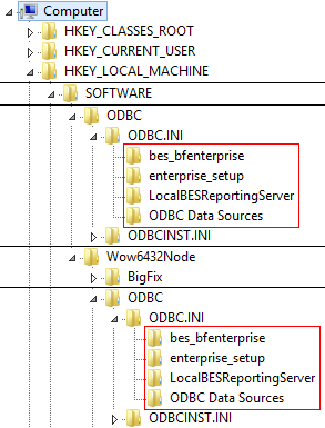

This image shows the ODBC keys of a computer with both the BigFix Server and Web Reports installed.
ODBC keys in the Windows registry
