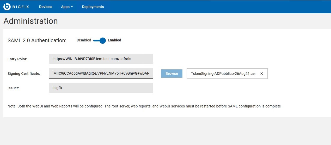

- In the Administration page, specify:
- Entry Point:
- The Identity Provider login URL. It is the URL from where the
operator can log in and be redirected back to Web UI or to the Web
Reports, for example
https://<idp_fqdn>/adfs/ls. - Signing Certificate:
- Browse for the certificate file or paste in this field the key from the Identity Provider certificate in Base-64 encoded X.509 (.CER) format.
- Issuer:
- Enter the Identity Provider Identifier in a textual format, for example "BigFix". If you are configuring ADFS configuration, this value must match the ADFS Relying Party Identifier setting. If you are using Microsoft Entra ID, the value must match the Client ID used when the Identity Provider was added (see Adding Microsoft Entra ID as Identity Provider).
- After filling in all the fields, click Enable.

An administrator can use the Administration page also to update the existing configuration.
