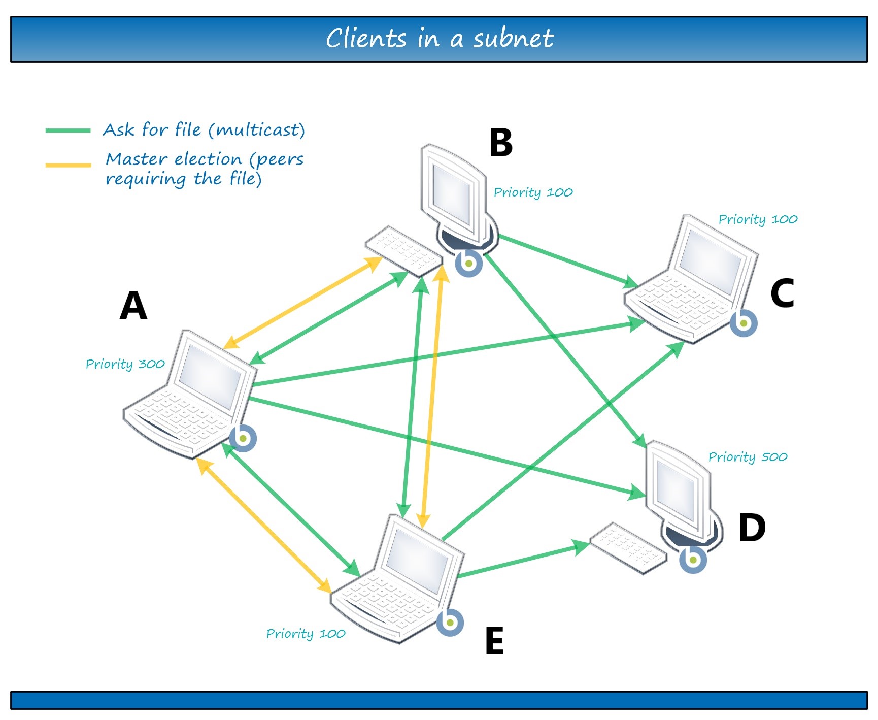

When multiple Clients are executing actions requiring the prefetch of a binary file, they check with their peers if the file is already cached in the subnet. If the binary was not cached then the Clients can elect one of them as responsible for downloading from the Relay (Figure 1): the peer with the highest priority, among the peers requiring the file, will manage the download; if all peers have the same priority, the computer with the lowest ID will download the file from the Relay. By doing so, for a given action, all files will likely be downloaded from the Relay by the same computer, and so the downloads will be serialized (one file at a time), thus ensuring minimum bandwidth occupation in the link between Relay and computer.
The following figure shows in details the master election process:
  • A will be elected as master as it has the highest priority among the peers requiring the file (A, B, E).
  • C and D do not require the file, so even if D has higher priority than A, D is not involved in the master election process.
Figure 1: Master election

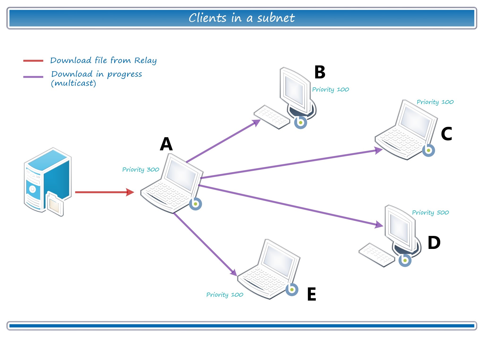

As soon as the elected master (A) starts downloading the file from the Relay (Figure 2) it notifies the other peers that there is a download in progress, so they wait for it without taking further actions. The master sends periodic notifications about the download.
Figure 2: Download in progress

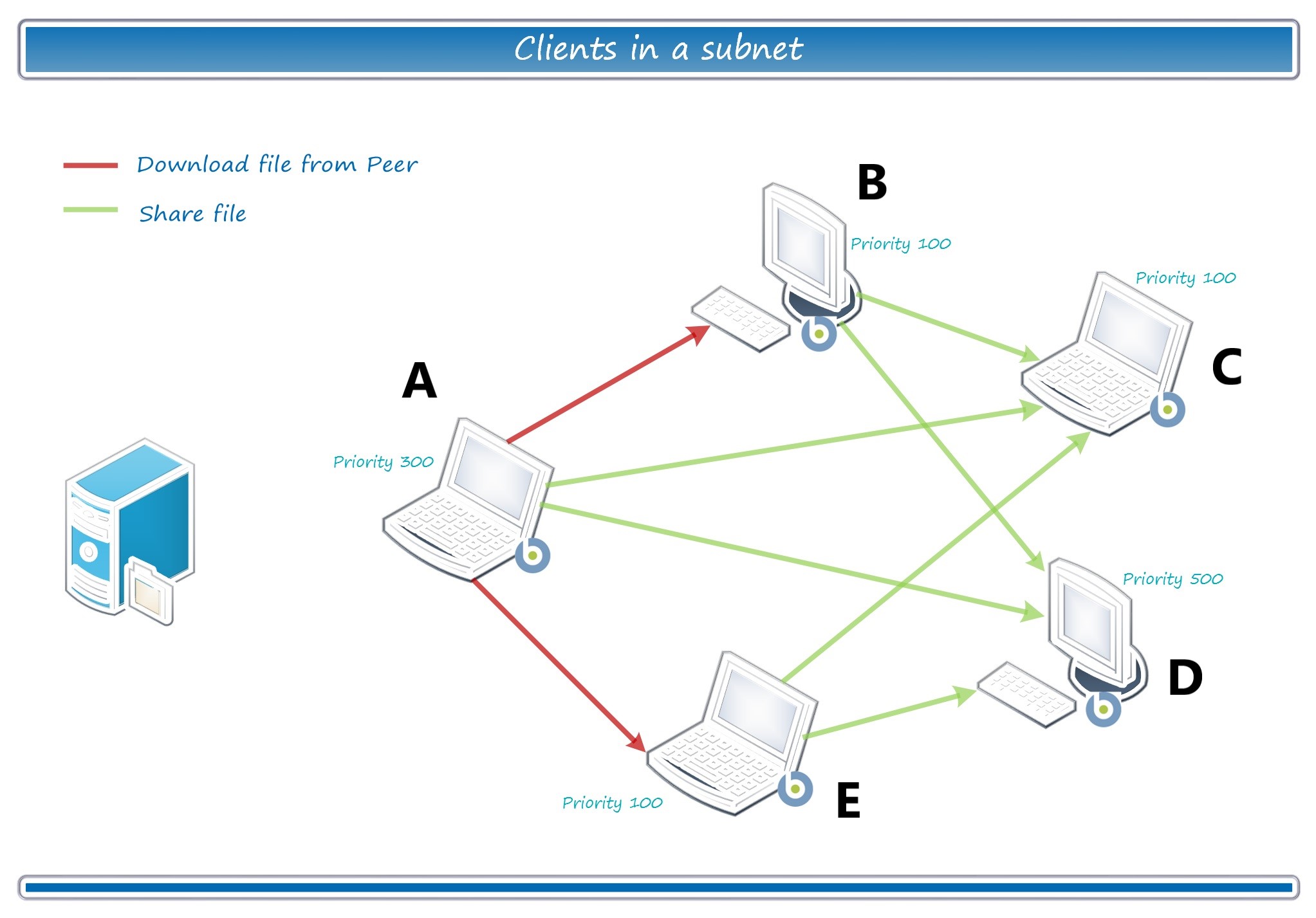

When the elected master finishes the download, it moves the file into the PeerNest cache and notifies the other peers about its availability; the peers interested in the file then start downloading it from master and share it, using the same mechanism (Figure 3). In this way, multiple Clients generate on the Relay the download load of a single Client, because only one Client downloads from the Relay and then shares the download with the peers.
The following figure shows how the peers interested in the file (B, E) start downloading it directly from peer A, instead of downloading it from the Relay. When their download completes, the file is cached to be available for future usage: so the Clients A, B and E will share the downloaded file with C and D.
Figure 3: File sharing
Clients with peer enabled will start up an HTTP Server listening on port 52311 for peer transfers. Each Client can serve at the same time a maximum of _BESClient_PeerNest_MaxActiveFileDownloads other peers (default value is 5).

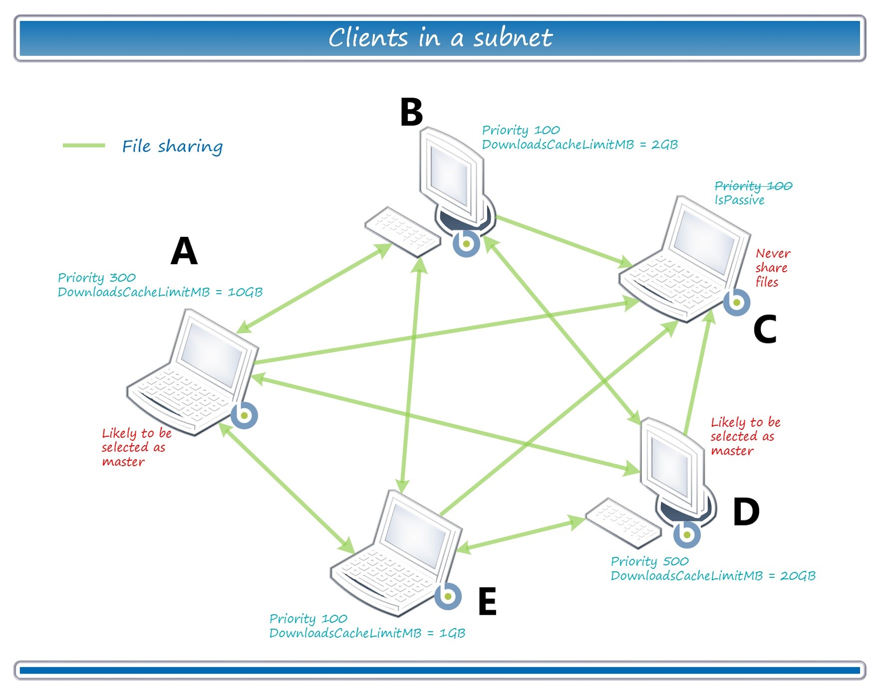

The Client priority comes also into play when there are 2 or more peers available to share the same file. The Client that wants to download the file creates a memory list of peers serving the file; it will pick up the peer randomly with weighted probability, based on priority: for instance, if the memory list is made up of two peers, say C1 with priority W, and C2 with priority 2W, picking C2 will be twice as likely as picking C1. In this case, the legacy retry-behavior applies – ruled by the _BESClient_Download_RetryMinutes and _BESClient_Download_RetryLimit Client settings – with the following addition:
  1. The peer from which a failed download attempt has occurred gets removed from the memory peer list (unless that peer is the only one in memory), and so the next attempt will be done with another peer.
  2. If the retry-count reaches the limit, the Client will go to download the file directly from the Relay.
If the Client fails to download the file because the peer that it has tried to connect to is already serving 5 downloads (default case), the retry-count is not increased and the peer is not removed from the memory peer list.

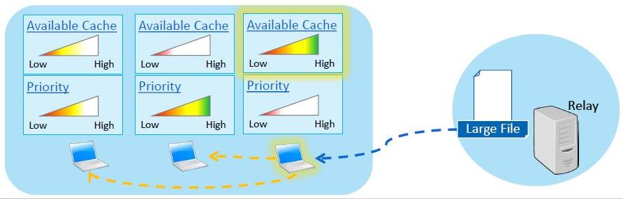

PeerNest behavior for files bigger than the PeerCache size
Starting from Version 10 Patch 2, a new feature allows time optimization for actions that require prefetching of large files. This feature ensures that the peers elected for downloads are those with real ability to store files rather than simply those with highest priority.
In fact, prior to Version 10.0.2, in a PeerNest configuration, when BigFix Clients are performing actions requiring the prefetch of a binary file, they check if the file is already cached in the subnet. If the binary file is not cached yet, the BigFix Clients can elect one of them as responsible for downloading from the BigFix Relay and then sharing the file with the peers. The elected peer is generally the one with the highest priority assigned. If the elected peer does not have enough cache to store the payload, the distribution fails, and all the other peers wait needlessly.
Starting from Version 10 Patch 2, with the _BESClient_PeerNest_UseNoSpaceDownload setting, you can configure the PeerNest to elect for downloads only the peers with a cache limit higher than the payload size. The same option forces the peers with high priority but not enough cache limit in passive mode. In this way, you avoid that the peers have a useless waiting and the file is downloaded sequentially. With this option, you also provide the peers with the ability to download the file directly from the BigFix Relay without waiting for the other peers that might eventually fail.

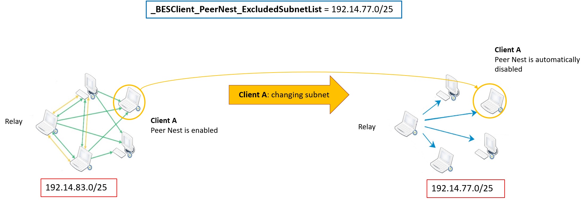

Excluding a list of subnets
Starting from Version 10 Patch 4, a new feature allows you to disable the PeerNest mechanism for BigFix Clients connected to a specific subnet.
The devices that use the PeerNest mechanism, send and receive messages using the UDP communication protocol. When you have many devices connected on the same subnet, they share network traffic among themselves. This might cause an excessive consumption of network resources. According to your specific needs, you might want to limit the UDP traffic on some specific network subnets. For example, if you have BigFix Clients running in a VPN infrastructure.
Starting from Version 10 Patch 4, with the _BESClient_PeerNest_ExcludedSubnetList setting, that contains a list of subnets (for example: 192.1.77.0/25;192.1.77.129/25), you can exclude from the PeerNest mechanism the Clients that belong to one of the subnets specified in the list. When a Client with PeerNest enabled (_BESClient_PeerNest_Enabled = 1) registers with the BigFix Relay, the new feature identifies the subnet of the Client and checks if its subnet belongs to this list. If yes, then the PeerNest mechanism is disabled for the Client.
Moreover, when you need to change the Client subnet, for example when you connect to a VPN, if the new subnet is already included into the Exclusion Subnet List, the P2P mechanism is automatically disabled like shown in the following figure.
Adding/modifying/deleting the value of the new setting requires a restart of the BigFix Client.

A good practice is to assign higher priorities to computers with a better link to the Relay and enough resources to serve the other peers of the subnet (and possibly a steady power supply).
PeerNest requires an increased disk storage space for caching files. The default PeerNest cache size is 2GB, which is enough for many scenarios; it must be increased in case of transfer of large files (patch management, software distribution, etc.) in order to fit the cache. The PeerNest cache is intended as a temporary storage, so usage and lifetime can be fine tuned with the following parameters: _BESClient_PeerNest_DownloadsCacheLimitMB, _BESClient_PeerNest_MinimumDiskFreeMB, _BESClient_PeerNest_MinimumCacheDays, _BESClient_PeerNest_MaximumCacheDays.
